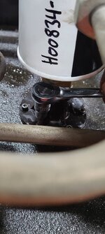

Anyone else still use socket caps?
Gurp
Jun 12, 2014
366
So.Ohio
I always have a set in my work box and my home box. When I mention them to people they don't usually know what I'm talking about until I show them.
Figured more people at work would at least. (Maintenance for a plant)
As a backyard wrench these have saved my bacon more times than I can remember. I don't use them often at work but they are great when I need them.

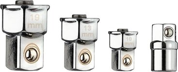

Like these? Always found them of limited use, but really needed when you need them.

I have the craftsman ones, they’re called wrench sockets, i find they come in handy when you get used to them.

Renegade1LI posted a pic of what they are. Basically shallow sockets but instead of having a drive square hole in the top, they have a hex head that fits in ratcheting wrenches.

OP needs to clarify wtf he is talking about.
Pretty obvious if you look the the picture. It is a hex head, 3/8" square drive to use with a standard 3/8" drive socket and a combination end wrench, or perhaps a ratcheting box end.
Good for when you need that 1/2" more height, and no room above the bolt head.

But he's using it on Allen heads it appears..it's dark... and the pictures after the first are of different things?
What is obvious.. from the variety of responses is..... it's not obvious.
Ok, Allen sockets too!
I am sorry, but two seconds looking at his picture I knew what he was talking about and I never knew they existed!

Honestly I think some people are giving the OP too much ****. He stated the correct name for the tool and posted a picture of it being used. If you search for "socket caps" on Google it's the first hit too. That some people still fail to understand and worse yet, blame the OP for it, beggars belief.

He certainly on about socket caps as in hex head to square drive adaptors that can get used with regular wrench or ratchet wrench .
They super useful, want a 4pc set that include 1/2 3/8 1/4 square drive and a bit holder .
They can be just the answer to some access issues and cheap way make your basic sockets and wrenches more versatile ...

I'd say the low profile sockets with built in nut are the modern version. (Like the Astro set pictured)
