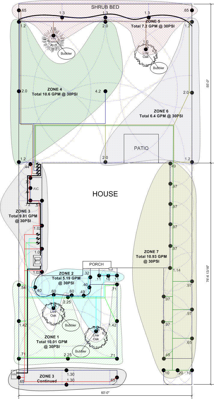

Awesome didn't know about sprinklerwarehouse.com, I really want to install a sprinkler system I think it should be fairly easy to do if I rent a trencher and the quotes seem about double what I think I can do it for, maybe even triple, Only problem is I have no idea how to do it and scared I wont' get the coverage I want. Rainbird has a design service but they charge for Texas and add all sorts of extra code requirements to our systems... Have you ever done one?
I installed my own using the info at:
http://www.irrigationtutorials.com/
This was before sprinklerwarehouse did their classes. I did buy everything from them and got it done far less than a contractor. I also now know how to repair the whole system. Here is a picture of my sprinkler design.
I had to redo most of the backyard when I put my pool in. It is all sprayers in the back now.
Steve

Dang Steve, that looks really good! Wouldn't be able to trade beer for help drawing up some plans huh? I'm not the slightest bit scared of the grunt work just nervous I wont' get my design right.... If you don't mind me asking about what did it cost you and how many zones do you have?
skamp
Jul 20, 2007
644
Cypress, TX

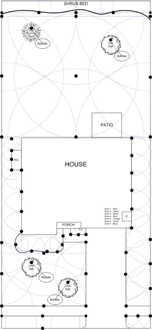

I have 7 zones (picture below) and the total cost including some laborers was like $1000. I also used higher end valves and rotors than the bids I got. I think the total cost of parts was like $600 or so. I am not 100% sure but I recall the bids being in the $1800 range. I have since converted zones 4 and 6 to sprayers becuase I installed a pool (picture below). I am sure that would have cost $800-1000 to repair and redo if I had a landscape company do it.
As far as the drawing it is not that hard. I used visio and they have irrigation objects. The key is getting a good survey to work from. I had one so it was easy to translate that to a layout. I made my life easy and just used 1" pipe everywhere with 1/2" "T's" for spray heads and 3/4" "T's" for the rotors. The actual layout and pipe install is easy. It is all the digging in the hard clay that is difficult. Also tapping the main line going to the house was a bit scary but not a big deal. If you have any questions or need help with that diagram, PM me.
Steve
