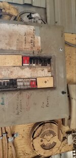

Anyone identify this old breaker panel?

I've bought a property outside of town with my first real, detached shop (yay!). Can anyone identify what kind of breakers these are? It's a 200A panel. Sorry for the bad picture, seems I forgot to take a real photo so this just came off my walk-through video. I have to confirm they're Siemens in the house and I'll probably try and find another for out here. This panel looks like it should have gone down with the Titanic.
Thanks!

Zinsco Breakers earned such a bad reputation among Electricians that they were not called Zinsco; but F**king Zinscos.
They were known for not opening and protecting the circuit and the Electrician working on it.

Beautiful. This forum is great; You guys see stuff and immediately know. Very much appreciate the experience. I've never seen one before, didn't know if it was even possible to use it as-is, but I've not yet taken possession of the building yet and Mrs Noltz will need me inside the house for a while yet.
Shop has 200A service but my meter is on a pole on the property, not on a building. I haven't determined if this is a main and the house (~200' away) is a sub or if / can the meter pan allows for two main panels?

The panel decal says Stab-lok.... So yes Federal Pioneer.
Just the handle design screamed FPE, & the colors meant Federal-Pioneer but still better then FPE, but if given the choice of Federal-Pioneer, or Eaton BR, I would vomit.:D

I recognized the handles too... but figured I should point out something more concrete. :)

according to an electrician I know well, he says that the Federal Pioneer panels in Canada are not the same as the bad firestarters in the US and are safe . I forget his reasoning .
They are the same stabs and outward visual appearance... and I have personally found burnt busbars and non-tripping breakers (especially 15A).
That said, it was a Schneider brand (the QO guys) in later years. I was installing brand new Stab-lok panels as late at 2004. They were still considered a budget brand; but perhaps a better product since Schneider took over.
I'm on the fence really. I cringe a little when I see a panel full of the old black breakers vs the newer white ones.
Canadian house insurance co's have so far not been screening against particular panel brands - noted particulars being knob & tube, aluminum branch circuits, fuse panel vs breakers, and 100A minimum service.
