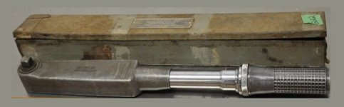

I borrowed this Jo Line torque wrench from a friend and then found this terrific
thread of the history of Jo Mfg.
This an air force issued Model 1202, Size 5, 1" drive, torque range 300-2000 ft./lbs.
There are 2 approx. 4ft. long bars that interlock to make an 8ft. long handle!
The broken alu. cast part attaches to the socket end of the head to add a bar out the opposite end.
I assume this is for a 2 man operation.

RJ:
Oh my. You have one of the monsters.
We called these "1202s" You can see that labelling in the "Model No." box on your tool. I am not sure why we called them that, but that's what we did. No other Jo-Line (or J O ) product was numbered like that. Maybe it was a military thing.
My recall is that the military and shipbuilding firms were the primary customers for these beasts. I never shipped any of them, so I can't now tell you who else other than the Air Force (which makes perfect sense to me) might have bought these. Even then, 1202s were only occasionally seen. I can't even tell you how many men were needed to use one of these monsters. Your guess of two makes sense to me. I do recall seeing them being tested and calibrated. One (large) guy did the testing, which involved putting the tool on a big scale and making sure it "broke" at the set torque value. My recall is that the testers put loooooong extensions (your two 4' bars would be those extensions) on the, well, "handholds" of these 1202s, and then pulled. Hard.
I mentioned in my response to NK a moment ago that the name of the company changed from J O to Jo-LIne in the 1962-1963 period. That puts the date of manufacture of yours to 1962 or earlier. Yes, yours has JO/LINE on it, but my understanding is that this was considered an occasionally used branding item when it was first used. The name of the company itself changed from J O to Jo-Line in 1962-1963, and the name "J O" never appeared after that. However, the JO/LINE branding may mean that your tool was manufactured in the period late 1950's to 1962-1963.
I'd be really interested in what you and/or your buddy want to use this monster for. I've always wondered about that. The 1202 always struck me as a largely useless tool.... until you had that one job for which only a 1202 would do.
Bill
Bill, my buddy has bought and sold military and industrial equipment all his life. I am designing/building a very large spring winding machine for a customer and need to know the torque required to bend 5/8" to 1" steel around different diameter mandrels so I can select the power train.
When he said he had a large torque wrench....I had no idea it would be this big!
Thanks for your reply.
