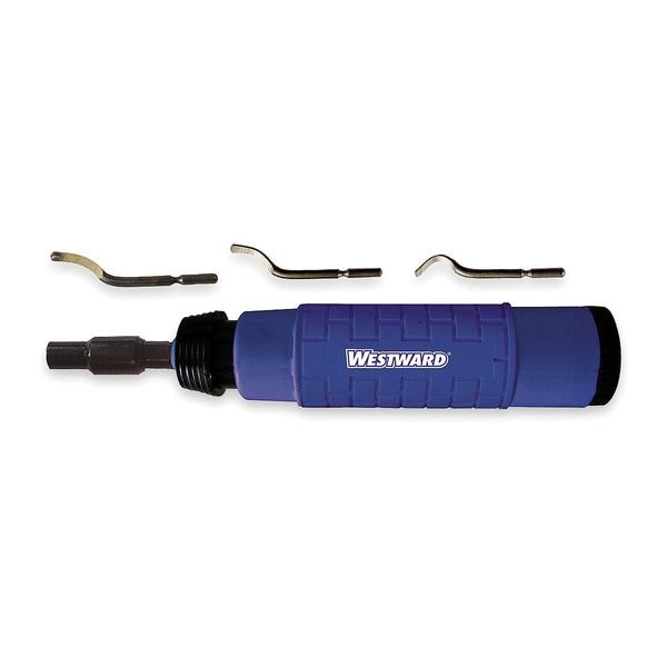

Are you talking about deburring an edge or counter sinking? The tool you pictured is a countersink.
Assuming you mean deburring : I don't need to do that too often, but if it's possible I'll just use a larger side drill but gently. Also the tang of a file will work, and I have one of these by another company (in red)
Shaviv, I believe, is the company that makes the red ones, that's what we have at work. Don't really work well in a threaded hole, but otherwise great for deburring sharp edges.

Speaking from several decades of experience as an inside machinist (meaning I worked in a machine shop and set up, operated, and programmed machine tools, thereby making thousands of machined parts) the above-pictured tool or any of similar type is the best choice for deburring holes. It will also work on edges, but a file is usually a better choice for that type of deburring.
Note that the above tool takes a bit of getting used to. The blades are a bit fragile and will snap off if you aren't careful. A sharp blade and a light touch will usually do the job.

epossum,
Thanks for that post. how do you use one of those tools?

epossum,
+1 on WD-40 and using a press whenever possible.
My most recent interest in this subject came after needing to do a freehand job.
you just swirl it around the opening. the blade is free and swivels, as you go around it will take off the edge.
speaking of which. i went to the pawn shop to go look for secret santa steals. found a vargus twist a burr with 2 carbide burrs in perfect shape in it. i wasn't gonna pay much for it considering they are 15 new. 1 dollar for a good deburr tool as a backup to the pen one i have. not bad. worth the money spent if you buy new, even better when one dollar.
^^^ I use one of these. Shocked as to how well it works. :pimpflash
