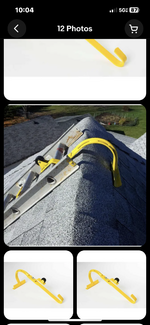

OP, you could get an attachment to convert a regular ladder into a roof ladder, the wheeled side is pushed up the roof surface without causing any damage, then the ladder is flipped over so that the hooked section locates behind the ridge preventing any risk of slippage.
Quick and easy to position, reposition as needed and then remove.
For extra safety, you could tie yourself off to the ladder.
The advantages of using a roof ladder is that you are not relying solely on your footwear being able to grip a sloping surface for balance, (so degree of slope doesn't really matter) and you always have something to hold onto (the ladder rungs).

Well looks like a pretty easy pitch but yes for most not comfortable
Get one of these for your ladder
Roof hook, hook ladder, etc
