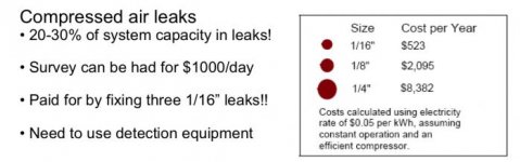

just gonna throw this out there - I've seen this firsthand and when people finally realize that air leak they've spent $30k on over the past few years was money they'll never get back, they're pissed.
