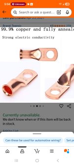

I'm replacing a lug, with a lug....an actual UL Lug...
you said you are going to drill out the rivet and replace it with a bolt. thats modifying the bus bar. doesnt matter that youre using an NRTL listed part. hell that part may not even be listed for that panel
how about posting some pics to show us whats going on.

he did. then switched it to a lug
After Mike suggested and gave me a link to a lug, which will work.
And no you cannot get a lug "for" that box. Yea it is a modification....but i don't care lol. You guys would be screwed in a 3rd world country without your new stuff, codes, and UL listings.

And furthermore there is no need to post a picture. I have a workable solution, that is as safe as the entire situation will permit and I am moving forward with that. Thanks.
I also showed a picture of a similar fuse box, and pointed out the lug...
