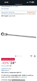

Anybody try the Astro Goliath Impact Extensions yet? They look burly; looking for feedback on their effectiveness to transfer more torque to the bolt head.
I've been thinking about it. They're on Amazon now.
Hopefully they show up on TTC soon and we can get an idea of how much torque they actually save (if any) vs more traditional extensions.
