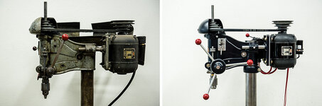

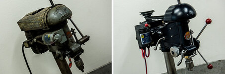

Here is my latest find and next project. Sorry in advance, this will be photo heavy.
It's a 1940s Atlas 63 that been Frankenstein'd quite a bit. It looks to have original paint (quite a bit missing though) under a ton of dirt and grime, a hacked front belt cover and falling apart belt guard, a Square D reversing drum switch, a depth stop from a Delta Press, an unknown concoction of a pinion / handle, an unidentifiable quill lock handle and a smashed start capacitor. The previous owner said he had been running it this way for the past 8 years as the capacitor was smashed when he moved it...crazy. Everything runs smooth despite the belt that is crumbling apart. The only part that I am slightly bummed about is the pulley cover. Somehow I did not notice that it had been cut up, likely from some kind of pulley mod at some point in its life. I can deal with that though, if anything it tells a story. It will get smoothed out / filed down to look as factory as possible.
I am going to resto-mod this one as it doesn't have all original parts and I have been itching to do work on a drill press. Based on the serial number and model, I am pretty sure this is an early 40s press with a ton of history and that's one of reason's I like it. There is just something about these 1940s drill presses. The simplicity, the main casting, the pulley cover, I love it. As it sits, it has 4.5 thou of run out. Not bad considering the condition / age.
I also took a quick look at the wiring box on the side of the motor and was pleasantly surprised that things were done quite cleanly when the drum switch was added. Planning on doing new wiring all around, new bearings and cleaning, polishing, brushing and painting just about everything. The paint on the KC motor is actually in very good shape and may only need touch-up after being pulled apart and cleaned.
This one is going to take me a while to complete so I am going to use this thread to document the work and hopefully share some of the journey. I know this may not have been the best candidate for one of my restorations, but I kind of dig the fact that there is so much "wrong" with it. I have high hopes of putting some lipstick on this pig.

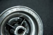

I also spent some time working on the pulleys. There is still some grime on the inside of each so I may have to run them through the ultrasonic again for a lot longer to loosen the really stubborn stuff. They are cleaning up quite nicely however.
Motor pulley. Congress Tool and Die Co. 5-4-3-2
Before soaking the castings in Simple Green, I removed the badges to try to preserve them the best I could. The main badge is a little beat up. I am thinking about repainting the red portion to bring it back to life. The plan for now is the try and get rid of the small dent as well as i can and then repaint the red portion, leaving the rest in tact. The base badge is in good shape and that will go back on as is.
I was able to cut through the rivets pretty easily without damaging the badge, but the remaining portion of the rivets in the casting are giving me some trouble. I have new cobalt drill bits coming to deal with that.

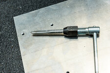

I had acquired a 3 spoke factory handle hub, but it did not include the rods / ball ends. Thinking that would be an easy find, I went on the hunt. I get a lot of satisfaction from finding off the shelf components that can work for a specific use case. I was having trouble finding what I needed due to the 7/16-20 thread size.
I finally found a solution. I ordered double sided threaded rods (or as McMaster calls them, connecting rods) in 7/16-20. 9in total lenth with 2in threaded sections on each side. Once cut down, it gives me a ~6.5" rod with ~.75" threads on each side.
These were ordered back in January in stainless steel but were back ordered until March, or so I thought. While messaging with McMaster, they told we they were indefinitely back-ordered, but they had the aluminum version in stock and ready to ship. Done. If i have any issues down the road, I will replace them with steel, but this is a great option for those looking for replacement handle rods.
I used 2 shaft collars as cutting guides to get nice straight cuts on the rods. It worked out perfectly.
All cut to size.
And test assembly. Perfect.
One step closer to having this thing done. I will polish the rods, currently they are just raw aluminum.

I ordered up a piece of 1/8" thick aluminum plate that was 10" x 7". Perfect to fit in between the motor and motor mounting plate. I drew up a quick template in CAD, printing it out full scale and used it to center punch my holes.
Hole centers transferred.
I drilled and tapped the switch mounting holes for 1/4-20.
Then, I drilled the top and bottom holes of each slot with a 3/8" bit. I had the drill press hooked up temporarily to drill these holes...nice to use itself for making parts.
After drilling, I connected the holes and smoothed everything out. I also rounded the corners off.

It's done!
Here are a few before and after shots before all of the details.
I put a ton of time and effort into this thing, but it was incredibly rewarding. It is probably nicer than it really deserves, but it is a pleasure to use now. Every single part, piece of hardware and motor was completely taken apart and refreshed. New bearings, new belt, custom wiring, a few custom parts (cover place / chuck key mount, switch mounting plate), and some new old parts all made it into this restoration.
The table has a decent arc of shame, but oh well... it is part of the history.

When I bought this drill press, I started looking for a Multi-Speed adapter pulley only to realize they were relatively hard to come by and expensive when they did show up. Now that I am done with the restoration, I decided to build my own multi speed pulley assembly. I went through a few iterations in SolidWorks, but ultimately came up with the below design using off the shelf components from McMaster / eBay.
Rendering of the assembly:
Parts needed:
2.75" Shaft Collar (4" OD)
4" x 0.5" 6061 Aluminum Disk
NOS Baldor / Dodge 2 Bolt Flange Bearing (USA Made)
NOS Congress 5-4-3-2 V-Belt Pulley (USA Made) for .625" Shaft
