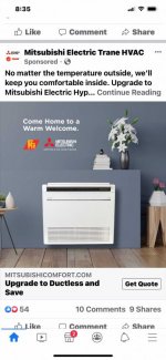

I have a bedroom / office in the attic that needs ac. There are knee walls on three sides.
Has any one Installed a unit ( like hotel) that doesn’t need a condenser outside ? I can run a water drip line through Eves in roof soffit
I have tried a roll around unit.
To loud.
I’ve seen these units. Will this work ?
Thanks!!

Put a floor mounted mini split in, they literally make a unit specifically for problems like these. These type units mount on the wall a couple inches above the floor line. Seems like it would solve all your problems without the introduction of future ones.

That is a minisplit

That's a floor console mini-split. They work great !

I just installed a floor mount mini split in my loft. Works great! You can see it under the window.

FYI -- most floor units allow for partial recess mount.
There was a contractor around my beach place who regularly fully recessed them -- he built concrete formed houses. They would sit so the top were at the foundation top -- along the first floor window sill height

I guy I used to work with put a mini split in his upstairs with 2 foot knee walls. He bought a standard high wall unit and mounted it on the knee wall and he told me it was working fine.
Now the problem with a high wall unit is they blow the cold air out the bottom of the unit. Like other posts, manufacturers do build floor console units where the blow the cold air out the top. Perfect for this situation.
