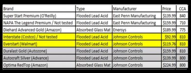

Need recommendations on dependable batteries.
Recently exchanged a 2mo old DuraLast for a DieHard, one month ago. It was deader than a hammer this am in 15F temps. That's the 2nd,well 3rd, AutoDie in the past 6mos.
No evident parasitic drain. They didn't even check 'em, just swapped 'em out. Remember the DieHard commercials from the '60s where they left the cars with lights on? Guess they aren't the same.
So what is a good battery.
thanks

There are only about 3 battery manufacturers. It sounds like the vehicle has a problem.

Battery disconnected; MM across terminals; brake switch disconnected, etc. Thought it was bed light. It's like it is intermittent.
Maybe I'll just put a cutoff like on my Chevelle.
FWIW it is 2003 Tundra (red)

Deep cycles have solid plates normally for long life. However this results in 600 cca for a group 27 battery. It weights 50.3 pounds. https://www.interstatebatteries.com/products/srm-27
A premium starting battery has 810 cca and weights 49 lbs.
https://www.interstatebatteries.com/products/mt-27?productLine=auto&subcategoryKey=&ignorecategoryid=true
Pretty good actually for as high of cranking amps
But group 27 batteries are a poor point as they are relatively rare as a modern starting battery in care. Even size 24 are large now.
Size 24 premium interstate with same 600 cca as the deep cycle only weights 41 lbs.
https://www.interstatebatteries.com/products/mt-24?productLine=auto&subcategoryKey=&ignorecategoryid=true
Or a size 75 battery with 700 cca only weights 34.5 lbs.
https://www.interstatebatteries.com/products/mt-78?productLine=auto&subcategoryKey=&ignorecategoryid=true
If I picked cheaper brand batteries and not the premium line of interstate the difference would be more pronounced.

I have always bought the Interstate Batteries when not in a pinch and they last for their warranty and then a bit more. You get what you pay for. I bought a Duralast Gold battery once...10 years ago. It had the typical 5 or 6 year warranty. It still works like a champ starting any one of my 3 classic V8's, one being a high compression Pontiac 400. Otherwise known as "the battery eater." The key with the Duralast is that it has never seen regular street use. I use it as my shop battery for moving cars around and the occasional spare when my daily driver needs a new one.
All that said, you are using a top name brand and going through 3 of them in such a short time indicates that you have something else going on.

I have found AGM batteries provide years of reliable service. Big negative is initial cost. I believe "New" batteries like NorthStar are more reliable than "reconditioned"

From my experience as well as vehicle forums I’m active on for over ten yrs.
Lead acid does not play well w/ on board battery management computers. False battery codes, post and cable depositions, cable and terminal corrosion. Price replacements for the new coated cables results in a double ding. If you want to mess up an engine compartment that you spent hrs. detailing, just pop in a LA battery.
Been running Odysseys since 2005. Have not replaced one yet. Price is now double what it was then. Chargers are supposed to be specific to their batteries. I’ve had issues w/ generic digital chargers, but my old Schauer is happily compatible. A fraction of the size of LA they can be position in any configuration except upside down. So, 16 yrs divided into current price of +- $250.00 = $17.00 per yr. Can’t do that w/ LA unless you scam the warranties. Optima has been **** since manufacturing went to Mex.

Here is how I do a parasitic load test on anything newer.
-Open all the doors and use a screwdriver to close the door latches. Disable underhood light.
-Unhook negative batt. cable and use a jumper wire to reconnect negative cable to negative post on battery.
-Let vehicle sit for 60 or so minutes....dont touch anything.
-Set meter on 10 amp setting, hook in series between neg. batt. cable and neg. batt. post. Positive meter lead on neg. batt. cable, neg. meter lead on neg. batt. post.
-Remove jumper wire from second step.
-Check meter reading for excessive draw.
If its excessive then I will do a voltage drop across all the fuses and hopefully find the circuit in question.
If I find a large voltage drop across a fuse (there is a chart for this) only THEN will I pull a fuse to 'double check' on the meter.
Some people will start pulling fuses one by one instead of doing a voltage drop across them, but then when you stick that fuse back on and it wakes up the module it powered, you're back at square one, which is sit there and wait for that module to 'go to sleep' before you can continue testing.
Clear as mud? :)
