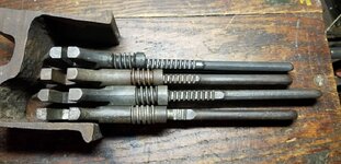

Here is an auto wrench made by Bridgeport Hardware. IMG_9162.jpegIMG_9163.jpegIMG_9164.jpeg
A
AntiqueBen
Aug 4, 2021
1,442
i guess the plan was to take whatever tool you were producing and call it an auto wrench and see if it flew. It seems like most of the other designs faded away pretty quickly.
I agree. Looks like they made minor changes to existing wrenches & called it an auto wrench. Your right too that those designs didn't last long once the typical auto wrench design caught on. Maybe since Ford decided to go with the typical design from Moore Drop Forge, the market realized that's what a lot of people would be using. Ford produced & sold over 15 million Model T's alone & they all came with tools including that Moore auto wrench (I think). It's an interesting time for tool manufacturing during the automobile boom. Nice Bridgeport!

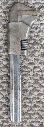

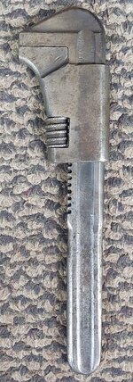

My Billings & Spencer Auto Wrench showed up in the mail today. This is the one that matches the pic in the 1901 ad. I have to say, this one shocked me a little bit. Most of my other auto wrenches, like the Moore Fords, Lakeside, Vlcheck & some unmarked 9" autos, are for the most part pretty lightweight. This B&S I got today dwarfs all the others I have in several categories. It's literally twice the weight of any other auto wrench I have in a comparable size. The handle & the body of the wrench is much thicker. The lower jaw body & block that moves up & down the threads is much thicker & heavier. I would compare it's weight & construction comparable to a monkey or pipe wrench of the same size. Probably like anything else. The first/older versions were overbuilt & they eventually cut down on material & made it thinner & less bulky to save money. Pic below of it next to a Lakeside Auto Wrench the same length.
The pics don't do this auto wrench any justice 😉
30,999
We're on the same page on that -
Good. Glad to hear that. I thought you were trying to say it had an ambiguous meaning even in heyday vintage technical literature.
Hmm, that's interesting. I have the same wrench (linked in post #19) and mine is the same if not slightly lighter than comparable wrenches, including a bona fide later version of the same wrench from B&S. It's possible that it's later than yours and marked exactly the same. When you say "literally twice the weight" do you mean it? Did you weight it? Or are you hyperbolizing?

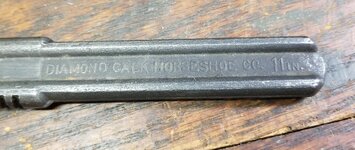

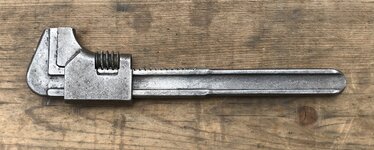

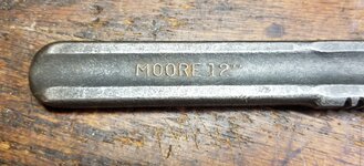

These are the auto wrenches I weighed. All 11-inchers, nominally, except for the Moore 12.
From top to bottom:
(1) Diamond Calk N.A.F. 1106-4
(2) B&S with a "Model G" stamp on the static jaw, a "The" logo on the dynamic jaw, (and dratted hanging hole drilled by a PO)
(3) Moore 12
(4) B&S, early logo in handle recess
Same lineup from this perspective...
Bona fides thumbnails...
30,999
And here are the weights...
(1) Diamond N.A.F. - 1 lb 9.3 ozs
(2) Later B&S - 1 lb 13 ozs
(3) Moore 12 - 2 lbs 0.3 ozs
(4) Early B&S - 1 lb 14 ozs

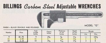

I'm very curious for you to get your early B&S weighed, Ben. If you don't have a scale or someone you can borrow one from, you can take it to the Post Office. Pretend you are going to ship it parcel post, ground, and ask for a quote. It will ship by weight in that category. They will want a zip. It doesn't matter what you use. Mine is 07704. When they give you the price to ship it to me, before they take it off their scale, ask what it weighs. They'll tell you.
Please also measure the OAL. Mine is actually 10-7/8". So is the later one.
There's evidence that the B&S Model G got slimmer through the years from 1915, 1926, and 1948. But only very negligibly. My early wrench - again, with the same exact marking as yours, inside the recessed panel on the handle, weighs only 1 oz less than the later version.
See thumbnails. Not exactly apples to apples, because the OAL changed. It looks like they were making a 10" and a 12" in 1915 and in 1926. They must have standardized on 11" sometime between then and 1942. But you can see that the weights of the 10" and 12" were very close to my wrench. Weirdly, the OAL is too long for the No. 3 but too short for the No. 4.

I see what your saying. So you think it's possible for an early (1901-02) B&S auto wrench that is supposed to be a 10" wrench could come off the assembly line as a 10-7/8", almost a full inch more than what it was supposed to be? This would mean it's possible for the 14" to measure almost 15" etc. I'm not saying it isn't possible, I've just never realized the OAL could be that far off of the advertised length.
Now that I think about it, 10-7/8" is closer to 11", so how do we determine if the wrench is supposed to be a 10" or 11"?
30,999
I am simply saying that none of these OAL questions or potential discrepancies based purely on ads can change the fact that our 10-7/8" auto wrenches bear the brand marking of a die they were using before 1915. And that marking has to trump anything else we can or can;t derive from trade journals, etc, about OALs.
I see the Early (pre-1915) ads indicating 10", 14" and 18", and later, they added an 8" and an 18". We KNOW these were probably "nominal" figures based on the later catalogs. The 1915 catalog I posted indicates that the No. 3 Model G, listed as a "10-in. wrench", is actually 10-3/4" in length. (That could easily be the 10-7/8" we are measuring.) It further indicates that the No. 4 Model G, listed as a "12-in. wrench", is actually 12-1/4" in length. The 1926 catalog doesn't bother with that nonsense. The No. 3 is listed as a No. 3 and in the Total Length column, it's 10-3/4". The No. 4 is 12-1/4". Note that the The 14-incher is not 14" and the 18-incher is not 18"!
A
AntiqueBen
Aug 4, 2021
1,442
Gotcha. I 100% agree that the brand marking trumps anything else, no doubt. So that's probably why by 1926 they stopped giving this OAL spec because it seems like they were never exactly what they were advertised to be to begin with. We are on the same page now 😉
I'm also currently researching how the location of the B&S brand marking on the wrench may play a role in understanding the age of the wrench. Not finished looking into this fully yet, but it's looking like the earliest location of the B&S stamping is located on the lower jaw block that travels up & down the threads (not sure of the proper name for this part of the wrench). Pic of this location below.
Edit: I know that brand stamps can be in different locations sometimes on a wrench from the same era. But trying to understand where the stamping was at the time of the wrench's release might be possible.
