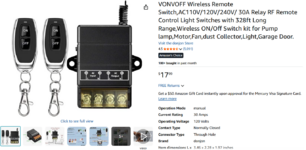

I just use one of these for my dust collector, along with a 240 V A/C relay, all built into a metal box. You have to wear the transmitter, and yes I'll admit it's not as convenient as an auto-on - delay off system, but you get used to using it - it's just part of my mental safety checklist.
View attachment 2437259Do note that it works at either 120 V or 240 V, and the pins that are marked L and N for 120 v can also be L1 and L2 for 240 V (the data sheet says as much), so that you don't need to have a neutral pulled.
I don't trust the AC output contacts on it; they say 30 A but I doubt they'll last long. I instead let the A/C relay take the abuse, as it's inexpensive and easily replaced.

In the 50 Hz world 240V does have a neutral.
OP is located in the US, and he wants to run a 240 V dust collector. But in any case 60 Hz vs. 50 Hz. is immaterial.
But to address what I think is the intent of your question / statement:
- the device pictured can run at 240 V input and output
- the A/C relay I chose has a 240 V solenoid, driven by the output of the device pictured
- and it likewise switches both H1 and H2 of the 240 V supply
Nothing in this system needs to run at 120 V, and I don't even bring a neutral out to it - the plug and receptacle on it are NEMA 6-20.

Downsides: you have to modify and build the relay-controller-board on-off control for each machine, have to constantly change batteries. There are more "industrial" remote controls but these are going to be considerably more coin.
The PLC idea is excellent if one wanted to actively control blast gates, as Mr. Slodat has already invented for his shop. But now one has a more complex system to design and control...pneumatic actuators...which in a shared-use shop (already noted people are untrustworthy) have to be placed out of reach or guarded so people can't get pinched or smashed by the motion controller, wire spring-return spool valves and the air-logic to respective PLC outputs and the air cylinders, have to get into some basic LOTO (lockout tagout) for working on the system which is controlled by something you can't see and can thus hurt you faster than you can react.
If you wire the relay in place of the push buttons, It will have the effect of "holding down" the push button. So the "on" machines are transmitting "ON" to the DC and the "off" machines are transmitting "OFF" to the DC until the battery fails. No?

Good point Dave, I went back and tested the remote control, it does draw current when the button is held in either state....so...not ideal.
There are two ways to correct this, one is to grab a 240vac > 12vdc power supply (very common LED supply) wired to the line side and eliminate the DC battery, also helpful for not having to maintain batteries. But it seems like there is probably a 99% chance that the circuits in the remote control are not rated for continuous use and something is going to fry itself in an hour. It would be worth testing this because choice two is really delving into complexity. This is why hardwiring is anyone's best choice.
Choice two involves timing relays to give a short interval closure of both the ON and OFF, probably need about 1 second either way. An Omron H3Y timing relay has a fairly economical ON delay (aka "interval") setup which can be used to provide the short pulse. One would be required for NO-triggered signal to "depress the ON" for the interval and a NC trigger signal to "depress the OFF" for a similar interval. Now we are talking about building a mini electrical panel for each machine vs. taking the time to route wires/electrical construction.
Like anything in life there is the (good, fast, cheap) conundrum, this solution aims more at the "not fast" choice.
