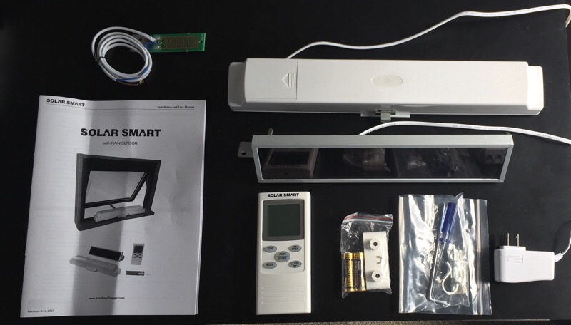

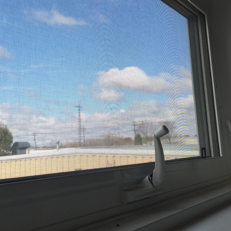

We've been using a very cool solution for the clerestory windows using Solar Smart Window Openers. These devices are solar charged, have a wireless remote and can be controlled by temperature levels programmed on the wireless remote. Windows can be zoned in up to 9 groups of nine windows each. The new models include a rain sensor so you can attach them easily to skylights etc. If your windows or skylights use manual cranks, you remove these and replace with the opener unit. It uses a chain drive to push the windows in or out...up to 60lbs of load. Because they are solar charged and wireless, retrofitting them means no wires to run!
I've been using two of them for the last four years with zero problems in our clerestory to make use of convective cooling. The on board lithium cell has kept itself charged up, and the windows have required zero service since installation. You can zone windows and therefore control them independently or in any groups you desire.
This is what's in the box.
This crank will be removed and replaced by the Solar Smart operator unit.

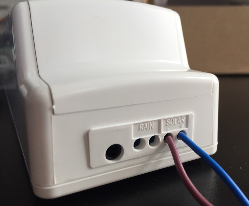

Connections for the included solar panel and rain sensor.

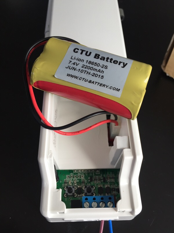

An end cap hides the replaceable lithium power pack, and connection block.

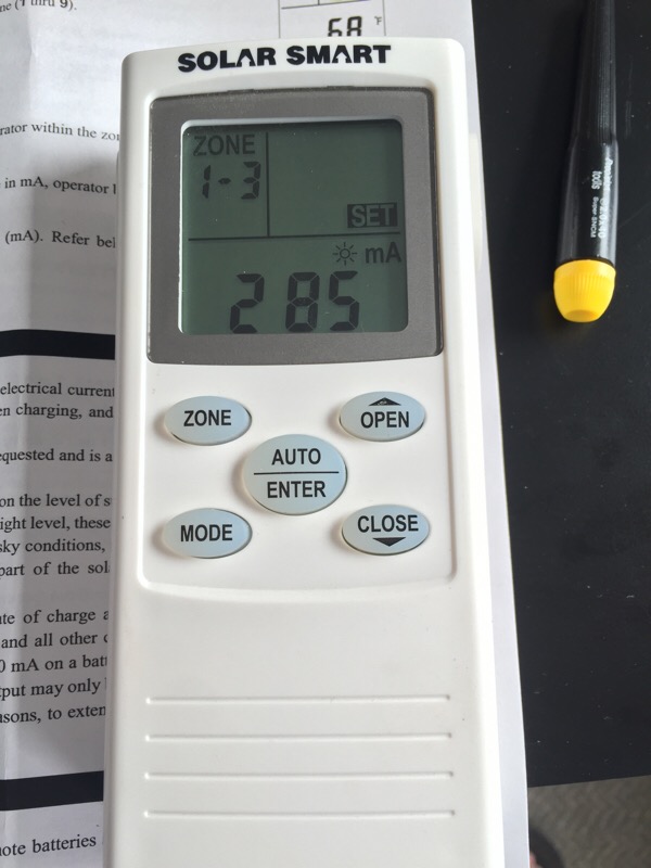

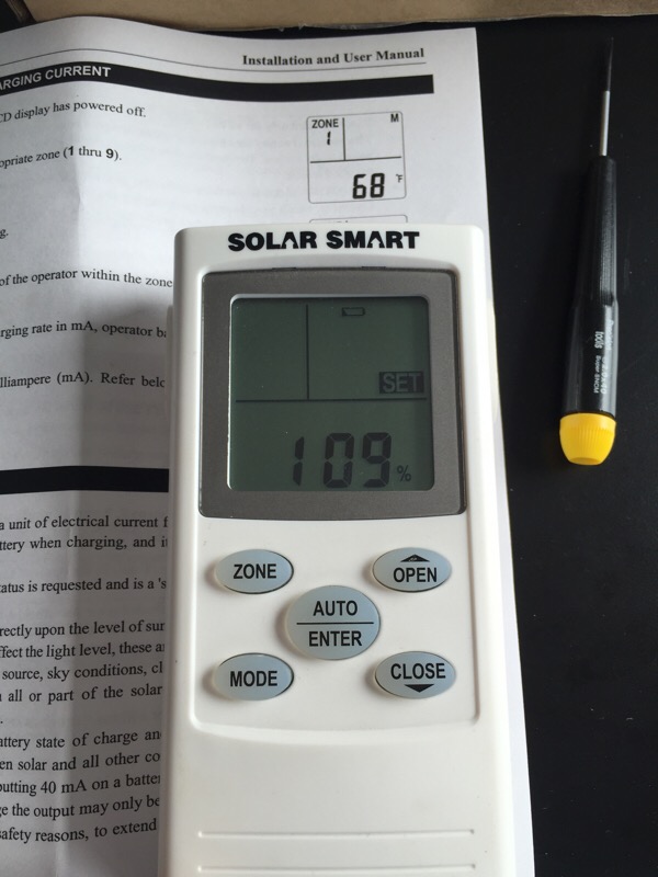

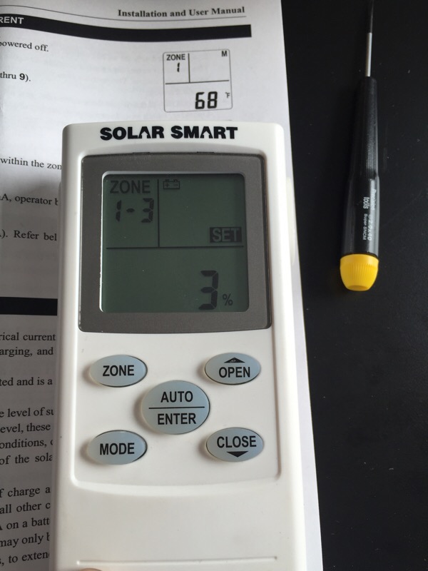

You can check on the Solar Smart Opener lithium onboard battery level, solar charging rate, and remote battery level of any of the operators.
This the current charge rate (from the plug in transformer to top up the cells).
Remote battery status.
The lithium on-board battery level, just installed. Once charged, the solar panel tends to keep the lithium cells at 100%.

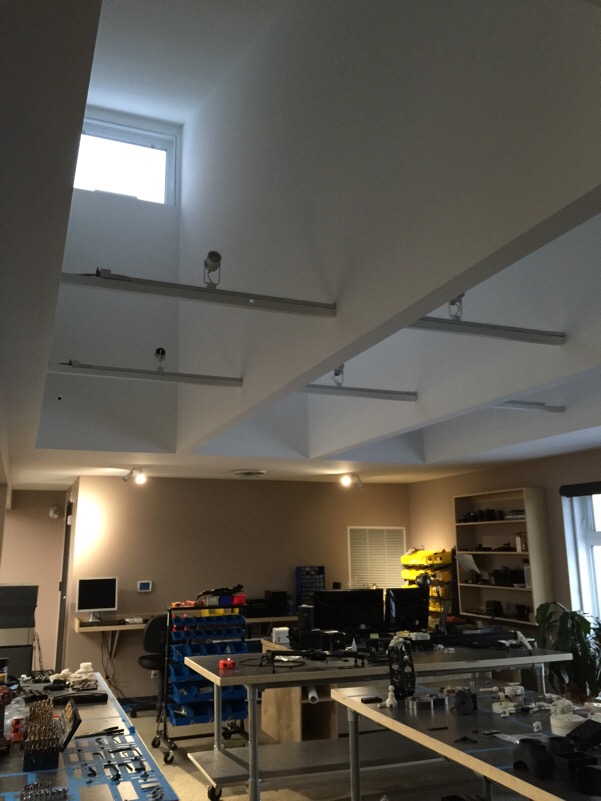

This is the clererstory we added in to the new office space. We modified a few trusses and extended the roof to create this south facing feature..my favorite in the building.
The Solar Smart Window Openers are used to operate these windows.

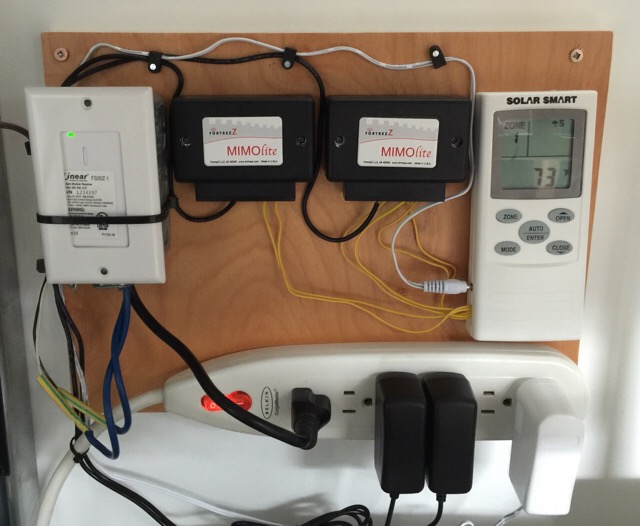

The board below is installed in our equipment room and to control both our HRV, and the window operators. The LFM20 relay on the left allows control of our commercial Venmar HRV ventilator located right above it. It's a simple Zwave isolated relay. The MimoLight units are also relays. One is used to open the windows, the other to close them. Each MimoLite has a signal input so I'm using this to indicate the windows current state (open or closed). Mimolites are often used to control garage doors. The ECI remote for the windows uses simple dry contacts (open/close) to send wireless commands to the windows. Fortrezz has a new product, the Mimo which is not available yet, but has dual relays..perfect for this job.

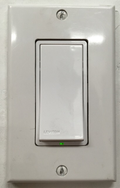

This Leviton Z-wave switch allows both manual and automated control of our workshop exhaust fan. It moves 1500 CFM or so, and works well when run at night to force cool air through the building.

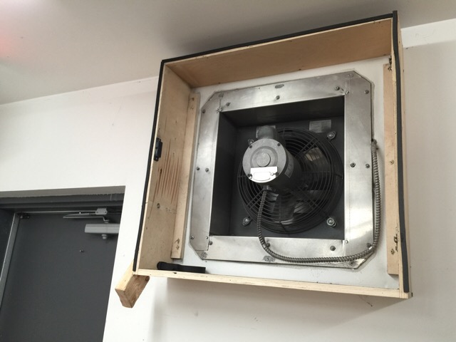

This is the fan, normally used to depressurize our work room. In winter, a removable door on the inside cuts heat loss when not in use.

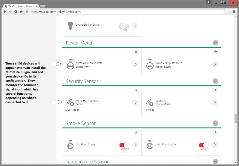

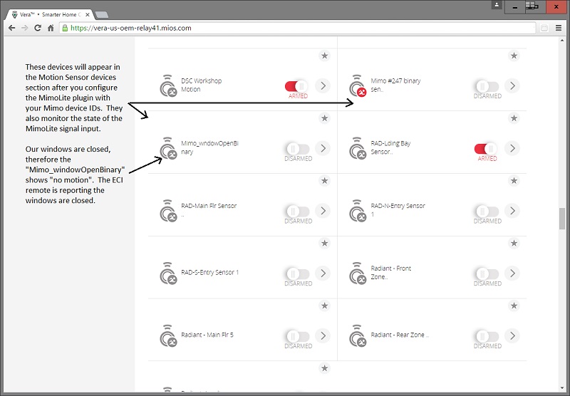

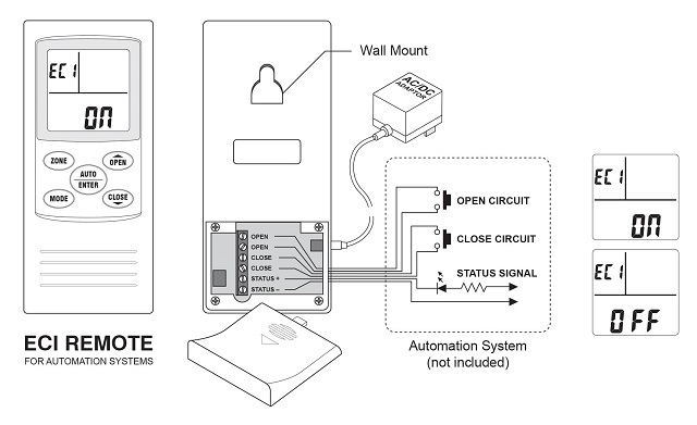

In case you are planning to automate the windows beyond the options present in the wireless remotes, here are few notes with respect to using a Vera controller and MimoLite Zwave relays to control them.
I was stumped on a few of these so had to make a few calls. Remember that these operators would work pretty much on any crank out skylight or windows. I've removed the window manual cranks, and installed the Solar Smart openers in their place.

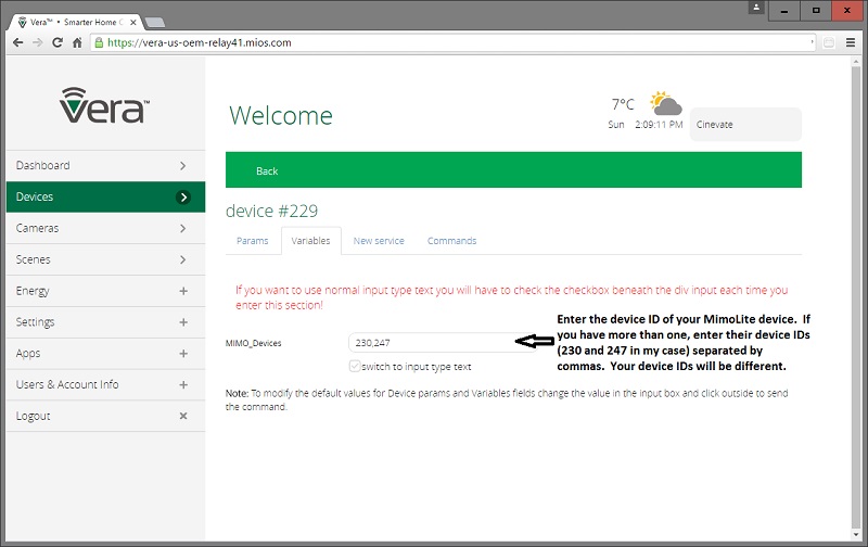

Step one is to install the free Mimo plugin on your Vera box:
Go to Apps -> Install Apps
• Login if needed
• Search for "MIMOlite" and install it
• After the plugin is installed a new generic device will be installed

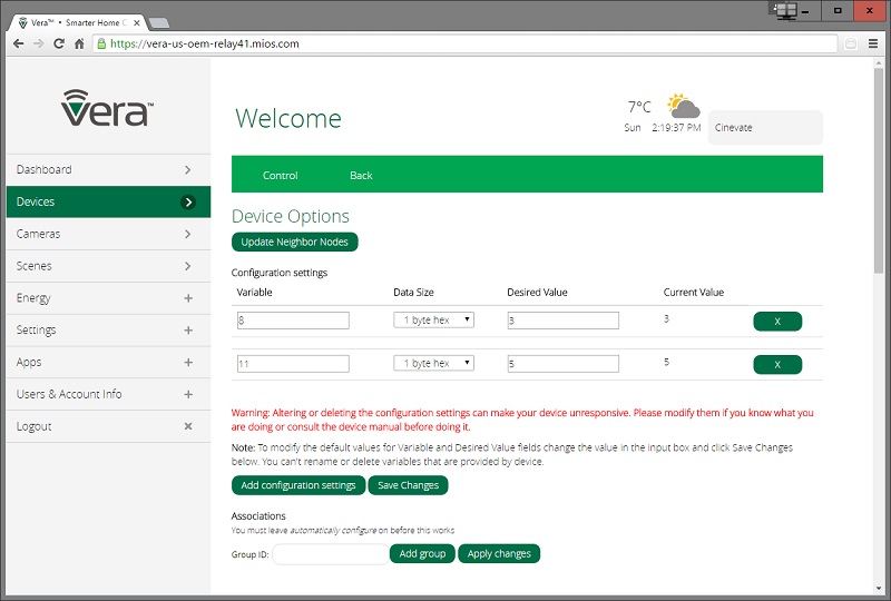

You can go ahead and include the MimoLite Zwave devices to your Vera hub now, adding them as a "Generic Device". Then fire up the plugin and enter the MimoLite device ID's. You can find the device IDs by checking the MimoLite (will show up as an On/Off switch) devices under the "Advanced" tab. The device ID on UI7 will show up at the top of the screen. Once you enter the device IDs into the plugin, (save, and wait for a few minutes) it will create child devices as shown below. The extra child devices monitor the Signal Input on the MimoLite relay...this is what makes the MimoLite as versatile as it is. Many use this input on a garage door sensor for example so you know when it is closed or open.
These parameters configure the MimoLite relays to act as momentary switches, staying open for .5 seconds. The ECI Solar Smart window remote in turn needs its dry contacts operated in this manner to open and close the windows. By default the MimoLite relays "latch" on or off...and this won't work for garage doors, the ECI remote etc. Mimolites are often used to automate garage doors.

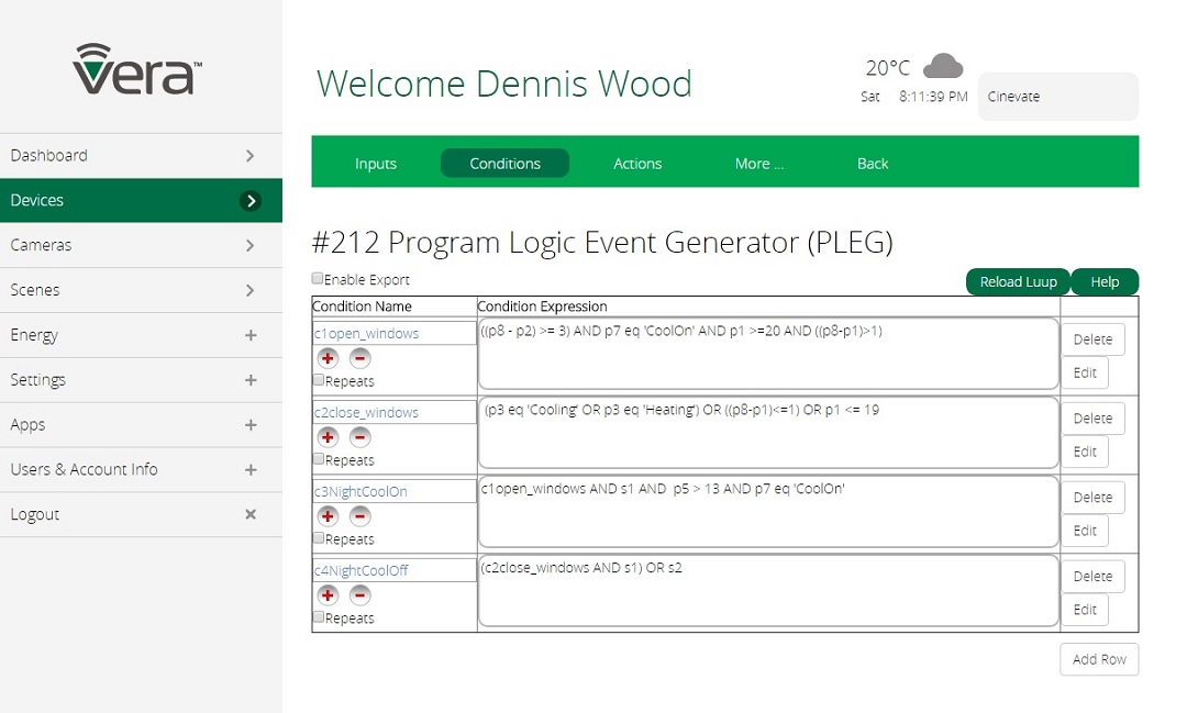

Night cooling with window control and building automation

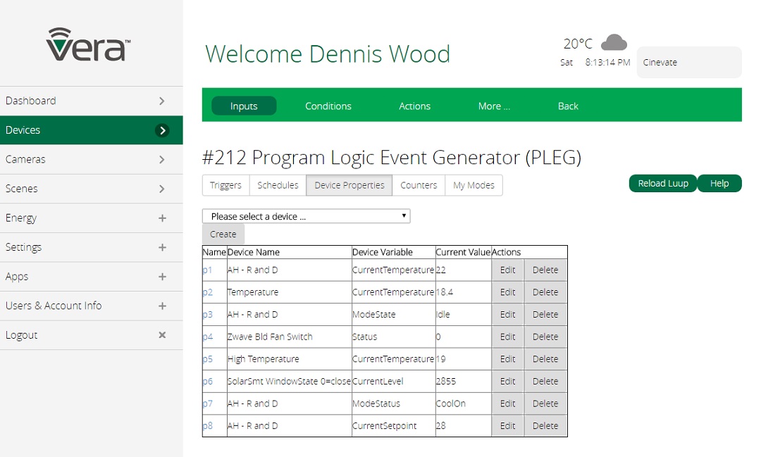

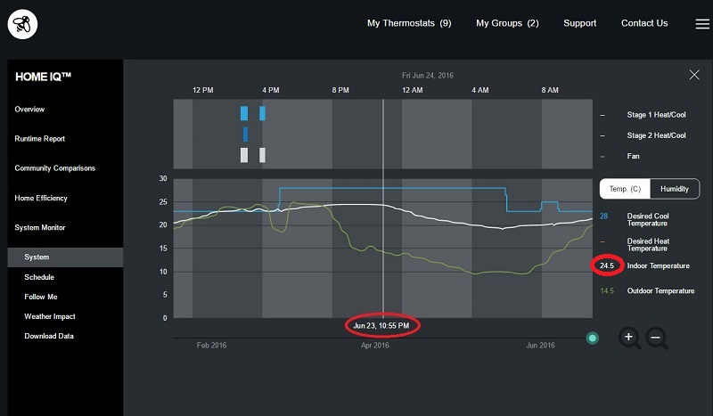

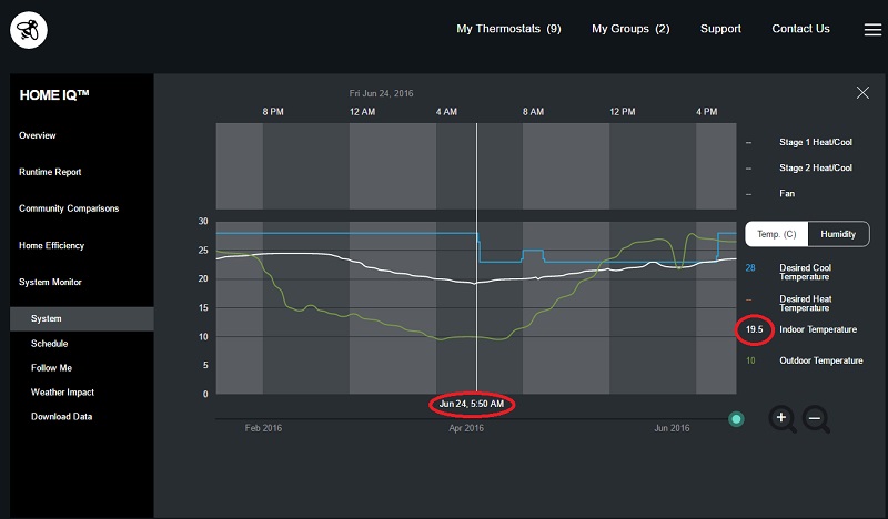

Here's an update of how well the automated windows and night cooling is working. Basically I have been working with a plugin called "PLEG" on the Vera automation hub to manage when the windows should be open or closed, and when the night cooling routine should run.
Basically I've found that these variables work best to decide when to open or close the windows, as well as when (or not) to run the night cooling routines.
1. Ecobee3 thermostat current set point (target temp) vs outside temp.
2. The next day forecast high temperature
3. Whether the system is in heat or cool mode
4. The difference between current inside temperature and outside temp.
PLEG lets you create logic using these variables as well as do some pretty impressive control without learning complex code.
We managed a drop from 24.5C to 19.5C (about 10 degrees F) over 7 hours controlling one exhaust fan and the windows. The space cooled is about 7000 sq/ft...so a large area. The graphs below from one of the Ecobee3 stats shows the drop from 11pm, to 6am...when night cooling is scheduled to start and stop. Night cooling will stop before 6am if the temps reach their targets early.
A few of the PLEG pages from the VERA automation hub. It looks complicated, but really it's pretty straightforward. You define various inputs and schedules as shown in the first screen grab. In screen grab 2, the four conditions are either true or false. Each has a corresponding action when the statement becomes true...open the windows, close the windows, fire up night cooling, and stop night cooling.
To simplify things a bit, the night cooling ON logic really only checks two things. Are the windows open? Is the time between 11pm and 6am? Night cooling OFF checks only two things. Did the windows close? Is it 6am? In turn, the windows open or close logic looks at the various inputs and setpoints to make sure windows are open or closed based on how the inside and outside temps are tracking to each other. The challenge comes in that while we want free cooling when outside temps can provide this, we also want to make sure windows are closed when outside temps rise, and AC is called for.
If anyone is interested in more details, PM and I'll be happy to share whatever I can. The night cool strategy lets us stay off AC until 1 or 2pm in the building...so definitely works.
