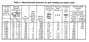

Spot welding literature indicate testing a weld "nugget" diameter based on material thickness and a peel test. So, time to cut out some weld coupons, weld them and test them. First, I tried pulling them apart with vise grips to no avail - so far so good, I think? Then I got out the air hammer and some ripped out, some split. I couldn't get a consistent parting, and the parts got mutilated in the process. I saw a video where a Honda specification "twisted" the spot welds. I tried that - but they all failed (No nugget). but it's clear that specification was for a different process and used a different style of spot welder. Finally, I stumbled upon a peel test where they used a tube with a slot and a T handle - of course. That's how to do it. So, I built a tool of my own. Indeed - I got very repeatable nugget pull out results.
So, in this application I believe 16 ga sheet metal (.058") might be typical. Based on that thickness the electrode tip diameter calculates to be around .22" diameter on both sides with equal metal thickness on both sides of the nugget (0.10 +2*T=.22"). I tried 2,3,4 and 5 second welds. The weld nugget diameter levels out at 3 seconds and 5 seconds clearly overheats the surrounding metal. 3 second welds feel and looks about right. The nugget diameter is on average .235" in diameter. I found some charts that suggest a minimum diameter of 0.14" for 16 ga. and although I can't seem to recall where I read it, I remember seeing 4-5X material thickness for nugget diameter. So far so good, I think.
So, I now either need to find the Ford weld specifications or get my hands on sample spot welds from the period - peel them and measure the nugget diameter for comparison. I am hot on the trail for both solutions right now.

Looking at spot weld charts they are talking about pressure in the 100's of pounds. No way you could that with hand held guns. But after using the tong unit I realized that I wasn't even close to that as well. I did a quick calculation and an 18" 5/8" diameter copper rod the most you could apply is 10 lbs before bending it. So the tong unit doesn't even get you there. So in actuality both units must generate similar welds.
RP
In the paragraph above you are equating pressure with force. That is not true. Pressure is force divided by area. Using your example of 10 pounds force on the recommended dressed tip diameter for the Lencospot (0.120"), the pressure at the electrode tip would be ~885 psi.
Another thing to consider in the energy flux (amps/area) between the contact area of the tip and the pieces being welded. It is energy flux -- not amperage alone -- that heats the metal sufficient to make the spot weld. This is very important for the relatively low power (30 to 50 amp) units we are discussing. For example, if we increase the dressed tip diameter of the Lencospot by 0.050", i.e to 0.170" from the recommended 0.120", we have doubled the contact area of the tip. This means that if we want to have the same energy flux across the weld as with the smaller tip, we either have to double the amperage or (as I believe neither of the machines we are discussing allows the operator to adjust the amperage) double the time of weld. We can only do that so much before we start melting the electrode tips themselves. Short story is that if we want consistent welds, we need to pay close attention to tip wear.

My error, not pressure force. See attached:
Tip diameter is dependent on the thickness of the joining materials. If they are not the same thickness you could have a different diameter tip on each side.
RP
PS in general I found the tip diameter goes like 0.10" +2*t = D
