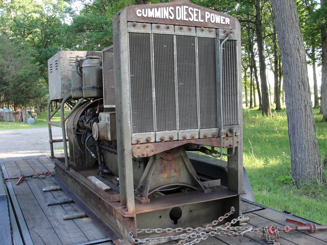

It's a Cummins so a little 4cyl onan diesel (I believe), hard to keepup with the Cummins/onan thing, certainly not a 4bt. 20kw.
Never seen an onan diesel. Sure didn't look like any cummins I had seen. The gen set have multiple engine sources however. The cummins branded genset we have at work has a John Deere 4 cylinder engine in it??
Note: I think your right on the onan diesel. Googlefu confirmed that onan used lister petter diesels branded as onan in some of there gen sets.
Interesting as my back up is a 6.5 hp listeroid single cylinder diesel
