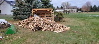

sennister
Nov 30, 2013
45
Twin Cities, MN
Ahh wood shed. Now that is something I need to build. We have been cutting down a lot of Ash trees as they are going to die anyhow with the Emerald Ash Borer and they were in the way for our garage build that I sent you a link to on the other forum.
One thing I did off this site was use it for my lighting plan. It looks like you are doing electrical next year or so but I used this thread for figuring that out.
https://www.garagejournal.com/forum/showthread.php?t=289441
If this is more storage than workshop, it is less important but it is nice to have good lighting. Mine turned out to almost be too good in that I didn't install all the bulbs. It is crazy bright in there.
