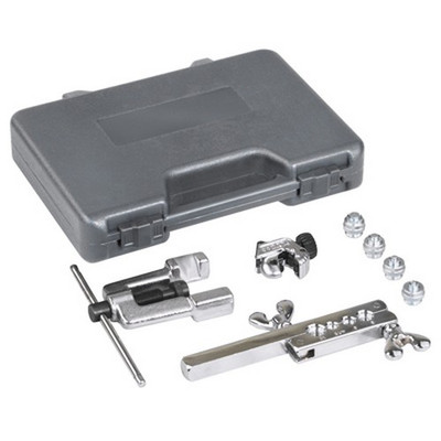

Bad bubble flare, cheap tool or..?
Burt Shaver
Dec 7, 2023
1,450
Iroquois, Ontario Canada
D774737F-72DA-4916-BD7B-7A947DAF1FE6.pngtrying to change a brake line on a 09 Elantra. I purchased this Bubble Flaring tool brand Performance Tool from Rock Auto. I am having much difficulty using it, I will just state some details in poker form. I purchased 25’ of NiCop 3/16 line, picked up the line and tool today. Tried about 10 test flares. At first the bottom of the bubble was all deformed, I think I got that worked out, I had to much brake line past the die block, 3.7 mm seems to work best for me which is just a hair over 1/8” . Also found that some lubrication with WD-40 helped the flare turn out better. So I had done some research online before buying this tool and it was my understanding that the bottom portion of a bubble flare is supposed to be at a 90 degree angle but this tool makes the bottom at a 45 degree angle? The top part of my flare I’m happy with, it’s the bottom that I’m worried about. Even the best flare I have made has imperfections from the rolling of the tool, the 2 sides of the die block are beveled and I can see this bevel in the bottom part of my flare. How perfect does the bottom part of the flare need to be? Also when I tighten the die block into the brake line the two sides of the die block are at slightly different elevations, maybe a 16th of an inch roughly, there’s a lot of play in the screws to tighten it. I will post some more picture that I have taken, I don’t expect to be making many flares in my lifetime so I was hoping to get away with using this chinesium tool for 23.88.
B
Burt Shaver
Dec 7, 2023
1,450
This is the best flare I could make, is it good enough to use? And is it ok that the bottom is at a 45 degree angle when what I e read says it should be at a 90? The old one I tool off was at 90 degrees.

They should change the name to Low Performance Tool. It's junk. There shouldn't be that much gouging on the tube where it holds. I had one of their chain tubing cutters. It didn't make one cut. The cutters rounded over and I threw it straight in the trash.

It looks like they're using the same tube bar for SAE 45° inverted flares and bubble flares. In my experience, those flare bars only have the 45° chamfer on one side. Try flipping it over and using the flat side.
Yes your right, in one of the video’s I watched only one side was chamfered to a 45 but both sides are on this one. Oddly the back side is the only side that I can make an even remotely nice flare in the bottom of the flare I mean. I’ve never done a flare so my word doesn’t mean much but the tooling on this tool seems bad to me.
This is going back if they will take it, from what I’m reading and hearing one side of the block should be flat for a bubble flare but bath sides are chamfered. I was hoping it was ok for the bottom side to be on a 45 degree angle.

I have a KD bubble flaring tool that I've had good luck with. I found that the 3 most important factors in a successful flare are -
1. Be sure the brake line is tightly clamped so that there is absolutely no movement of the line while flaring
2. Be sure the line is correctly positioned in the clamping part of the tool. On the KD tool the line is flush with the outside edge of the clamping tool.
3. Be sure you completely screw the flaring part of the tool as far as it will go. On my KD tool, it takes quite a bit of strength to get it completely flared correctly.
If any of those 3 things are off, it will result in a poorly flared brake line. It took a few practice flares for me to get the hang of it the first time I used the tool.

The flare tool is probably junk but the tubing can be hard and do that as well buy quality components really helps. For a good tool look at Imperial or Snapon hydraulic flare tool. Look at getting a roll of Kunifer brake pipe you will love working it is.
Try this brake line Advanced Auto has sold it in the past get a role of it. Flair one end and run it along your in tended route cut a little long use the hydraulic flare tool and flare the other end on the car. Very easy to work with and bend but you should fasten it more often then standared line.

The OP is using the copper/nickel brake line, AKA "Nicopp" or "Cunifer" as rodm1 calls it.
This stuff makes it far easier to create good flares, and it's definitely far easier to install than steel line. Not to mention it won't rust out like steel.

I have been using the OTC brake line flaring tool with good results since 2015. I made several brake lines for my old 2000 Ranger, & a couple for my 69 Mustang. They were all the double flare.
OTC is a good option for me, it’s the right price range, what does worry me though is you bought yours in 2015 and I think I remember reading somewhere on here at one time that OTC used to be American made and now it’s made in China? Have you heard this? Doesn’t mean the tool will be junk but.... may not be same quality as when you bought yours
