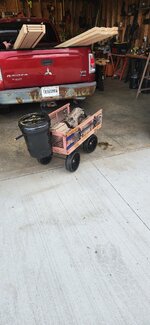

I have an old yard cart(25 years?) that I use exclusively to haul firewood around from my wood pile to my firepit. Because I over engineer stuff, I put a bucket mount on it to hold fire starter stuff and fishing rod holders to hold my fire poker and log tongs. I'm planning on giving it a paint job this summer. I upgraded the tires to Tweels because Northern Tool has them on clearance and my previous flat free tires developed flat spots. But now I also want to convert the pull handle to a ball hitch, as well as all my mower tow behinds, because I overdo stuff... But the old handle on my yard cart is only like 3/4 square tubing. So how does one attach a ball hitch made for 2 inch square tubing to lightweight 3/4 tubing? Or do they make ball hitches for smaller tubing? I can't find any online. Do I just need to weld a 2 inch tube on the end? Because I **** at welding.

Yes either weld a piece of tubing to the handle for the COUPLER to attach to our just weld the coupler to the handle. No, trailer couplers are not made to fit 3/4" tubing. Smh

Probably best to make a new drawbar,
. The stuff a wagon is made with is pretty thin, and not friendly to someone who has never welded before.
In the end, it’s probably to just buy a pin-on 2 wheel composite cart like the Rubbermaid, or is it Craftsman I have sitting behind the garage, waiting for new tires.
You mean the handle, which becomes the tongue?
The Cobbler
Oct 24, 2013
26,216
quite a simple task in my opinion. bolt thru the top of 3/4 square tube , thru the coupler with a couple of 5/16 bolts and call it done.
for added strength , not that you'll need it, shim the sides of the tube & coupler to take up the extra space

I've got a little trailer with a ball and I don't like it. I should cut it off and weld on a couple pieces of flat iron. That way I could just use a regular pin.
What don't you like about the ball hitch?
So I went out and double checked last night. The current pull bar of the wagon is actually 1 inch square tubing, but is amazingly thin, and for 25 years old, a bit rusty. And bent... It used to have one of those reversible handles, but that broke years ago. I found a replacement, convertible handle online, but they want over $40 with shipping.
So I think I'll replace it since I'm overdoing this thing anyway. I think I'll just get a new 1 inch square tube a little longer than the current handle and weld a couple pieces of flat stock to the top and bottom with slots for a hitch pin. I need to practice welding on something, so I guess a 25 year old garden cart is a good place to start.
That sounds very reasonable. Also a good project to practice welding on.

No need to overcomplicate things. For the amount of load you'll be able to fit in that wagon, you can just cut some wood shims to fit between the hitch and the handle and bolt it all together. It'll be plenty strong enough.
