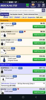

Update-rented a puller set from the parts store. One puller was already broken:( Tried the separator style but couldn't get it underneath the boot:( Last one worked!
3 bolts but took forever to reinstall, ended up breaking my torque wrench, it was only 40 yrs old :cry: , then the ball joint threads somehow got stripped and had to rethread them. I don't use my tap and die set often but when I do it's desperate!
Last pic is the reason I replaced the lower control arms. Cracked rubber and some separation from the rubber/steel.

Well, good job. I still don't see the reason for trying to save a ball joint if it doesn't pop easily.
It's not the cost of the ball joint it's the labor on the Journey. You have to take the entire brake assembly off. For me it would likely be 2-4 hrs each side.
seeing that you pressed directly against the threads on the stud of the ball joint, theres your answer. if you thread the nut back on the stud so that it sits flush and then press against that, it helps minimize the chance of damaging the threads (y)
