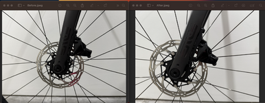

Issue: The Enve AR In Route Fork says it will support 140 or 160mm rotors, but I measured the caliper plate mounting holes and there's no way the caliper will get enough bite on the 140mm rotor, so my options are:
1.) 3D Print an adapter
2.) Run 160mm rotor up front.
Will post an official answer from Enve when I get one on why it was advertised to support 140 or 160.

3D printer to the rescue once again.....
Just doing this for Proof of Concept before either getting one CNC'd out of aluminum or just running a 160mm rotor up front.
Anyway, the spacing between the lowest caliper plate mounting hole and center of the Thru axle is supposed to be 23.5mm
Shown here:
https://support.enve.com/hc/article_attachments/25100221075355
With the original flat mount adapter installed, it was almost 33mm
Before:
Here's how it looks as far as brake rotor consumption with the new flat mount adapter I designed and printed.
After
Much closer to that 23.5mm now and much better pad/rotor contact
I'm doing some fine tuning to get the spacing for the plate bolt and caliper itself to clear. Pretty tight on v1 shown here:
Before/After:
v2 almost there, just need a little more clearance for the caliper mounting bolt
From top to bottom
Original
v1
v2 with better rounded corners
Underside of v2
v2 Mounted Countersunk.
Edit: Yep - just ordered a 160mm from Elevate Cycling to put this to bed.
I will post the reply I get from Enve though on this issue.

I'm not sure if you have used larger front rotors on other bikes? I do, I run a larger front rotor on all my mountain bikes, and I like it, it feels completely normal, but I think the extra front braking power is an advantage and it seems to keep me from locking the rear brake as often.
Btw, nice build, I'm not familiar with Walty, but it sounds like you got a deal on it.
I run 160's on my MTB, but my goal for all other bikes in the Haus is to keep 140mm on front and back so I can easily swap all the whelsets between the bikes that aren't mtb.
Yes, I know it takes literally 30 seconds to swap out a center lock rotor, but this is my wife's bike and I'd rather not have her bug me to swap the front rotor between wheel sets each time she wants a dedicated road wheel set on there.
I did end up buying a 160mm for this and Enve was fan-tastic!
