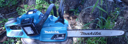

I rec'd my Makita today and spent some time doing some various cutting (small and big). I love this saw! The high chain speed is really nice for small branches. It instantly slices them clean vs grabs them and chatters thru the cut. I tried it with a 10" log and it took just a few seconds to slice off a "pancake". This will be a great "grab and go" saw and in a whole different league than my old Kobalt "toy".
Build quality is excellent and commensurate with my other Pro grade gas saws. The Makita rapid charger takes up a large footprint but only took about 45 minutes to get both batteries nearly fully charged.
Special thanks to member Rapid Badger for pointing out this version (XCU07) with real bar studs vs those silly thumbwheel chain adjusters.
In the future, I might pair this with the little Makita 10" top handle. That would be a great marriage for small stuff. My only nit pick is the main power switch which tends to timeout and shut off a little too quickly.
