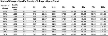

Here is a state of charge chart that covers a wide range of voltages. most of what I've read says to check the SOC 12 HOURS after a charge as some batteries can maintain a "top charge" for quite a while, giving you a false reading.
Pulse chargers (desulfators) send a "wave" through the battery plates that basically shakes sulfate off the lead plates inside the battery so that it can be redissolved back into the electrolyte solution. some folks swear by them, some say a properly maintained battery wont need it.
