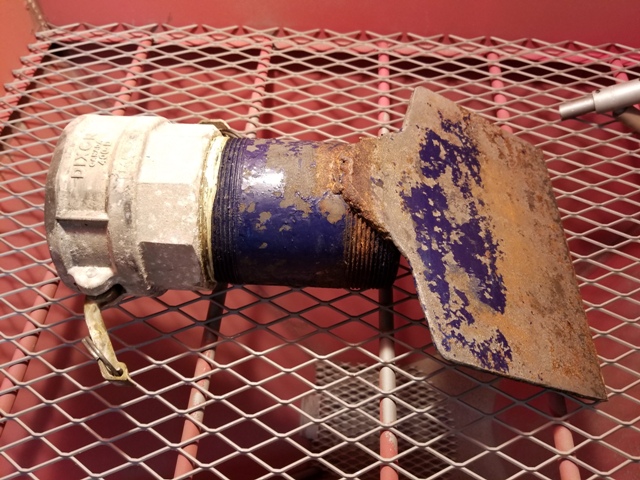

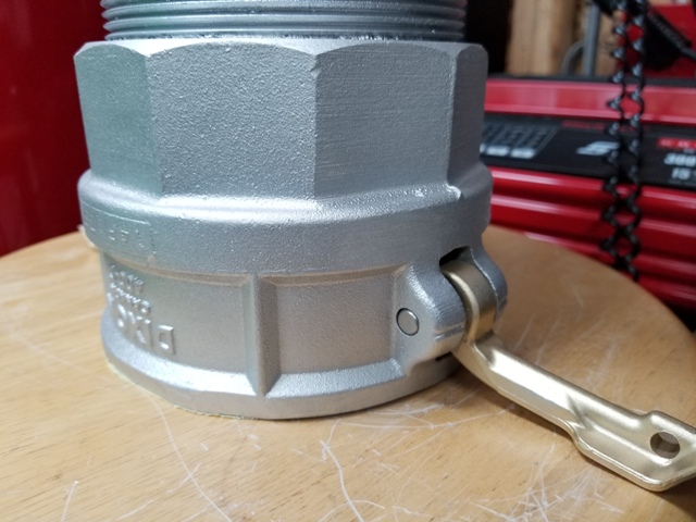

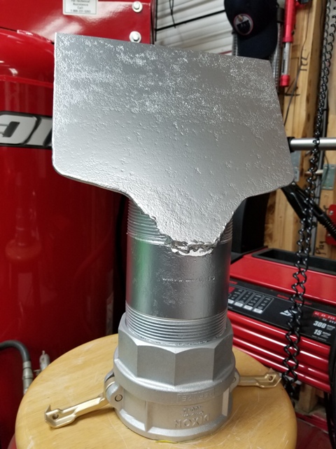

OCD
Dec 30, 2014
1,316
Edmonton, Ab. Canada
Here's a funny one!!
It's a part off our vac truck, that my Dad asked me if I could clean up... Challenge accepted!!
I blasted the steel pipe and diverter plate with aluminum oxide, then painted them with a new Tremclad aluminum color I wanted to try out...
Also glass bead blasted the connector, then clear coated it...

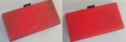

Here is a quick Before & After.....I got this in last weekend from GJ member "bluebolt" (thanks blue) and gave it the TLC spa treatment!
Started by washing the case with Dawn dish detergent and a tooth brush....then wiped it down lightly with Armor-All....
Before & After:
Got it all cleaned up and filled it with bits and my red ratcheting screwdriver (it came with a black driver)
20180928_193223.jpg 20180928_193244.jpg 20180928_193249.jpg 20180928_193253.jpg
The black driver clean-up coming up......

Well I am not sure if Milwaukee 38 Hammer Drill 5392-1 (made in USA) which is only partly metallic (Aluminum) qualifies to be posted on this thread or not but for whatever it is worth here it is.
Recently I bought two US made hand drills (Milwaukee 38 Hammer Drill 5392-1 and Millers Falls Electric Drill Model B 260A aluminum body) for grand total of $10.
The status of internal wiring insulation as well as cords for both was a bit of concern (as an example see first photo). So I changed the the internal wires as well as the extension cords
The second photo shows the Milwaukee after rewiring (but before full restoration). Since the sidle handle for the Milwaukee was missing I made an Aluminium (threaded) rod which I planned to use to build a side handle with (see last three photos).
The 3rd photo shows the Milwaukee after publishing and painting.
I used the aluminium rod (after cutting it to length) in conjunction with a $2 bicycle handle grip to make the side handle. Since the original side handle had a guard, I used to center of an old blank DVD case to make a similar guard.
Very clever building the handle for your new drill it looks great
