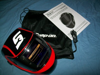

Hi, I've been wanting to learn how to weld for a while now. A couple days ago I was emailed a Harbor Frieght coupon for their Titanium 125 flux core welder, so I decided to pull the trigger, figuring I'd get this now to learn on, and could alway upgrade later, if need be, once my skills improved. So now that I have the welder, any recommendations on what else I need? Any brand recommendations? Any other tools I can cheap out on? PPE is pretty important to me, so I will invest in a quality hood. I'm looking at the Lincoln Viking and the Miller digital infinity or elite helmets. I know these are top of the line, but I figure my eyes are worth it. Between these models, which would you recommend? I'd really appreciate any advice you can give me!
Snap on helmet...
Low profile with light.
When you start welding I promise you that if you're welding on cars, trucks and equipment you'll bang your helmet off all kinds of ****. Particularly if you don't have a lift.....good lord.
If you'll never weld under equipment or vehicles and you'll be in wide open areas get a cheap auto darkening helmet but make sure it has a "grind" selection. Then you can also use it as a mask for grinding..etc.
Good luck.
That said...consumables...tips...all that stuff....
Country of origin is important!!!

That SO
Snap on helmet...
Good luck.
:eek:
Nope,
That Snap On helmet costs 3X what the HF welder costs...

That SO
:eek:
Nope,
I wouldn't know what anything costs at HF....
It seems odd that you're replying for the OP about an item in which he clearly stated...
"PPE is pretty important to me, so I will invest in a quality hood. I'm looking at the Lincoln Viking and the Miller digital infinity or elite helmets. I know these are top of the line, but I figure my eyes are worth it. Between these models, which would you recommend? I'd really appreciate any advice you can give me!"
Apparently I missed the OP stating they'd turn over all financial matters on protective equipment to you.
My bad
Here is a new one on EBAY taking offers...
Here was one at $399
So the OP is ok looking at helmets in the $300 plus range...as stated by looking at Lincoln and Miller top offerings...
That extra little bit for a smaller profile helmet with a light is absolutely positively worth that.
I promise you once they're welding and banging their helmet off stuff and having to fiddle about with a light....
They'll wish they had that helmet.
