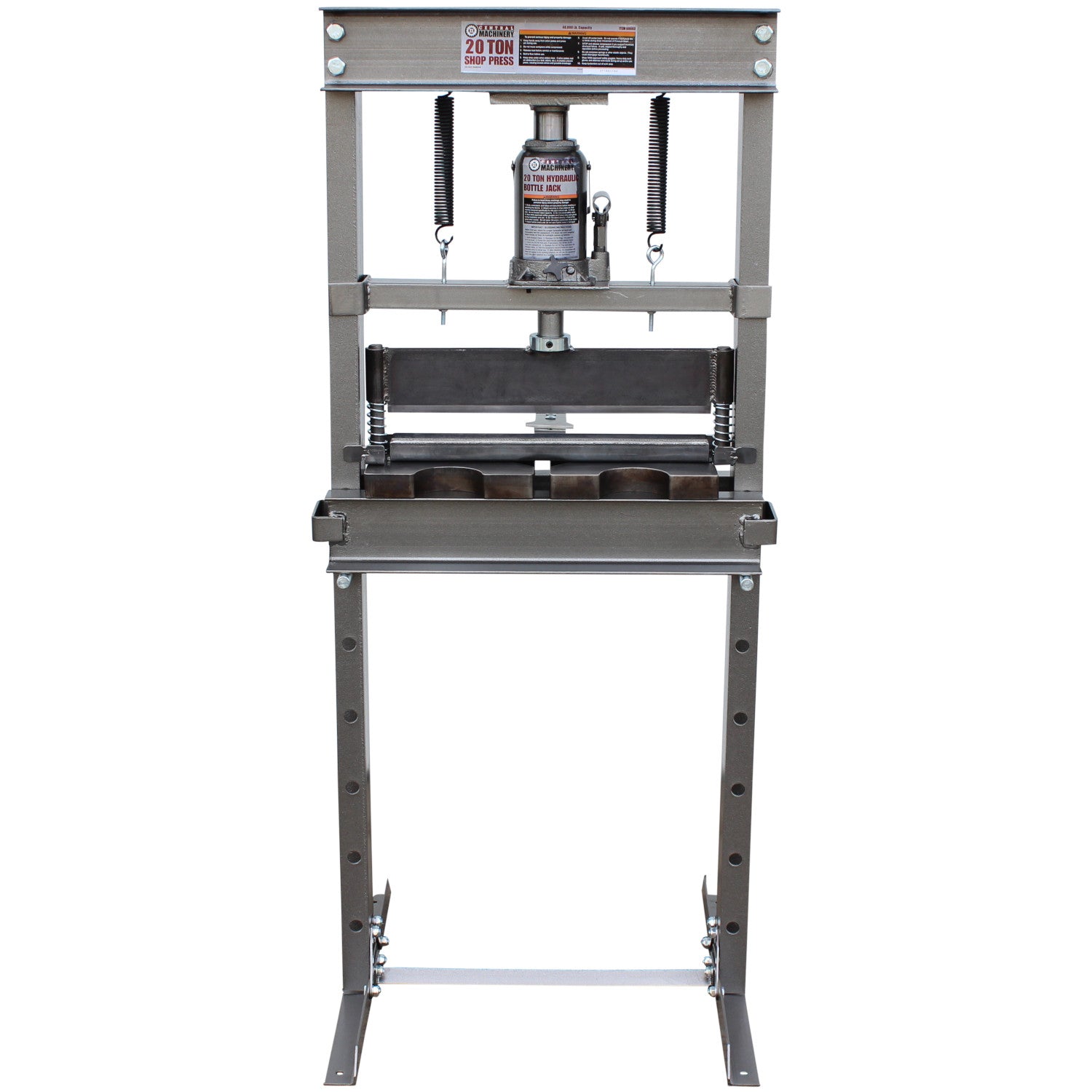

I’m taking a new approach on making my metal brackets. Is there any real downside to bending 1/4 inch x 2” flat bar into 90 degree angles?
Specificallly, will a single field bend appreciably weaken the steel? And would heating red hot then bending help, or hurt, in terms of final strength? Quench or no?
I’ve got the material to make a bending jig with a long lever arm.
Thanks

I have a 20ton HF press also. I change to a pneumatic 20 ton bottle jack. makes it easier to operate

I made a couple brakes for my press several years ago. I have no problem doing a crisp bend in 1/4 up to 8" wide. The first brake was just made from scraps and had had a ton of use which shows but it still works great

I purchased the finger brake set off of them, best purchase i made all year

If this is just ASTM A36 mild steel, a hot bend will not cause any significant reduction in strength. There might be some minor change in grain size if it is heated above the lower transformation temperature (1335 F), so keep it in the 1100-1200 range using a temperature crayon (Tempilstik) or a infrared thermometer. Quenching won't restore any strength because of the low carbon content of mild steel (0.30% or less), but shouldn't hurt either if you just need to cool it down after bending.

Every time I see that SWAG finger brake I wonder why I don't have one!
Not one complaint from anyone.
So useful too.
I have the 20T HF press and upgraded that to a 20T air over hydraulic jack and one of the best things I did was to go to a foot valve to operate the press. Leaves both hands free to guide things and much safer as you can stand to side of the press while operating it. Also added casters for easy moving.

I use my press for bending and I also have the floor mount bender from HF. I really like the hf bender as it can do curved bends as well. It will barely accept 2 inch flat stock, nothing wider.
