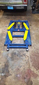

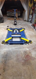

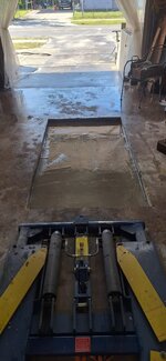

I bought a replacement hose and installed a quick disconnect fitting. Next i removed the shirt piece of hose joining the two cylinders, and replaced it with another hose tat has a T in the middle where a matching quick disconnect was attached. There's not enough clearance to use a quick disconnect on the side as the lift tries to snap off the extra over all length as it raises.
Today i finally bit the built and cut out a 45 x 80 inch area to flush mount the lift. It has to cyre for 3 weeks before i can use it but im really looking forward to it

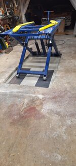

I finally finished flush mounting my mid height scissor lift last night after the 1/4" plate was delivered. Here's a few pictures. I know the 1/4" plate was overkill as the concrete is 4000psi and it's also 3/4" rebar reinforced. But since the footprint of the rollers is so small that rolling over .250" hot rolled steel plate put my mind ar ease.
