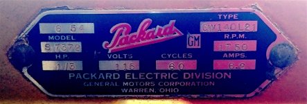

OK gentlemen there is an auction coming up on Sunday where I can bid on some BELT GRINDERS, as 454ragtop suggested.
I wanted to post pictures, but it says that I need a URL for my pictures. How do I do that? Use google drive or something? I would really love to get your advice on whether these are worth bidding on.
ges74
Sep 20, 2017
8
Ah, found the button.
So I apologize that I don't have pictures of the entire motor units but I figure it's the specs that matter since you can't witness the machine in operation.
The first two photos (Packard + Sears Craftsman) are one unit.
The second Packard is belted up with what looks to be a self-made bench grinder assembly.
The 4th photo (gold bench grinder - per research, looks like a circa 1960 Sears Craftsman?) is belted up with the blue motor in the back, have no idea of its specs.
The 3rd Packard is belted up with a General (couldn't find specs, only the attached labels).
I will post another final Sears Craftsman motor that is belted up with a belt sander.
So I was thinking I could go for:
The Packard/Sears combo
Or mix and match the motors/grinders. If I were to do that I would have to win two auctions and then discard of the motor/grinder/sander I didn't need.
Looking at these labels, is there any way to tell which ones are of better quality/specs? They certainly all seemed solid - no wobble, for example.

Those arbors you show are better suited to buffing or wire wheel use, note there are no guards or tool rests. If you can get one cheap they work well for that, and then when you find a grinder you don't have to swap grinding wheel for wire wheel or buffer. I think I like the General better, but only because it looks like it offers better access to the wheels.
Thanks for the input. The folks over on the American Association of Woodturners said I should just get a standard Rikon. The motors I posted aren't totally enclosed, apparently. And a guy here in Wilmington is selling a Baldor 8201W (low speed) for $300 but it's 3 phase and it looks like VFDs are $200 so that disqualifies that.
