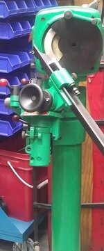

Drill Doctor is a reasonable bit sharpener for most domestic sharpening. I wanted more than a DD offered, so I bought a STERLING.
If you can find a LISLE 91000 they are a fantastic sharpener.
