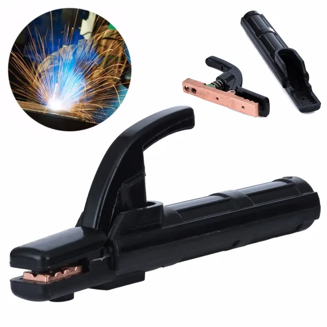

If I were going through these in quantity, I'd probably cut a groove into the jaws of a cheap pair of vise grips to grip onto a 1-1/2" length of wire made for the job.
And I'd probably cut a second groove at a 45 degree angle to the first, so I could hold the wire in two positions (think of the grooves in the blocks in the tip of a stick welding stinger).
