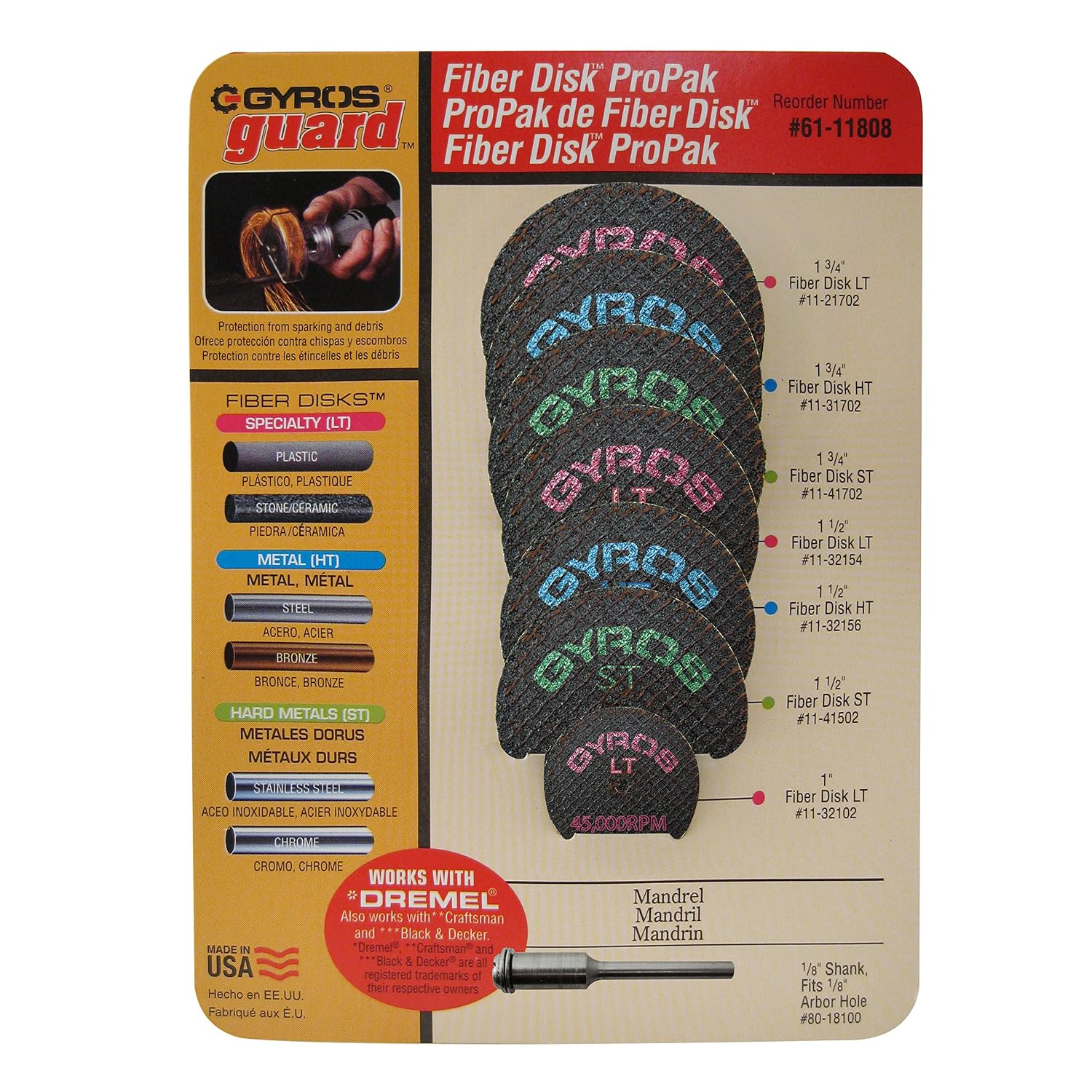

GYROS

flynnr
Dec 14, 2014
15
Thanks guys I am going to order the gyros and the ez lock set and give Er hell
