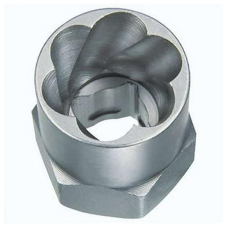

I rounded off a starter bolt on a 2010 Mazda6 and need an easy out to get the bolt out. I have very limited room, too. I have tried other easy out's (Irwin and Craftsman) and none have come close to gripping the bolt head. It is a 13mm hex head. I don't want to have to cut the bolt out or grind the head off. That would make things worse IMO. Anyone have any suggestions on a tool or better easy out to use? I have also tried vise grips, pipe wrench, gator grip etc., but like I said, limited room and no luck. That bolt is torqued in there good as well. And remember, steel bolt in a aluminum block with no anti-seize. Thanks for any help! Ethan

I'd use an Irwin bolt extractor. Find one that is tight and that you have to tap on with a hammer.
http://www.irwin.com/tools/screw-bolt-extractors/9-pc-metric-bolt-extractor-set

I have use the Erwin extractors too with good results. If you do end up breaking it or cutting the head off it might be easier to remove once the starter is out of the way and you have something sticking out to work with. Obviously that would be the last resort.

I use the Mastercraft version of those Irwin extractor sockets, and they are great. Took out an impossibly stripped head bolt with one shot of the impact gun.

Thanks everyone. I will try the turbo sockets. See if they will work. If not, guess I will get the welder out. :(
