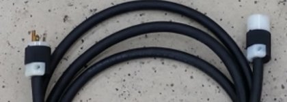

Recently, I've liked sourcing portable cordage and plug ends and just making my own. I've made a couple out of SOOW, and as was already mentioned earlier in this thread, it is totally overkill unless you are going to be doing something like driving over it constantly. The stuff is super thick, so a long run of it would be hard to store. I'll be using SJOOW from now on, which is substantially thinner, and slightly cheaper per foot.
Either way, SOOW is really, really nice cord. It'll outlast me for sure.

SOOW is over kill for sure, but it will probably last 2 lifetimes !
I probably should have paid closer attention to the diameter of the cordage when I bought it...oh well, too late now.
This is what I ended up with:
The top two are 12/3 SOOW, 20' each.
The bottom one is a 10' 10/3 SOOW, made specifically for a table saw that didn't seem to like being run on one of my existing extension cords.
