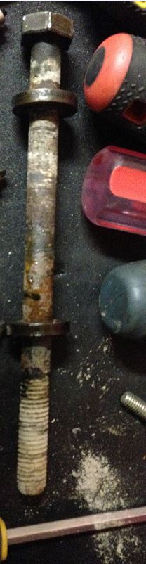

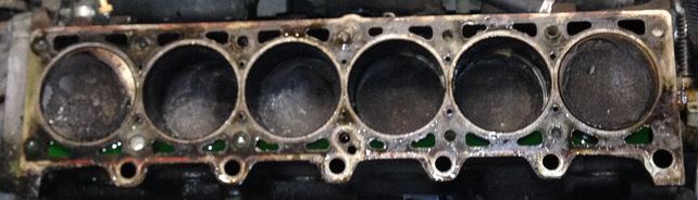

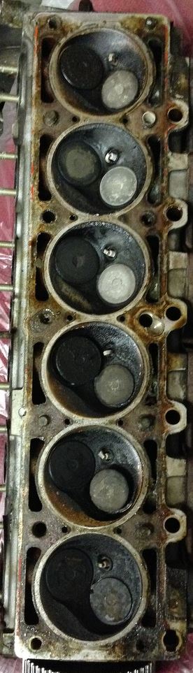

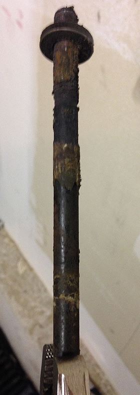

Headbolts from hell:
Some broke protruding above the block, some broke below the block, most got jammed in the head (took machinist a full day to remove).
The headbolt holes on this block are also countersunk, with some of the bolts breaking at the bottom and some at the top of that counter sink.
Good times.

I assume that was some type of farm equipment? It looks like it was recovered from a seabed.
Actually from a California car; ~30 year old BMW.
The headgasket had been replaced once before, which is the source of all the problems. I suspect the headbolts were not oiled, headbolts likely reused (TTY), and some kind of threadlocker was used.
Vintage BMW tolerances are very tight, which doesn't allow much room when things start jamming up.
