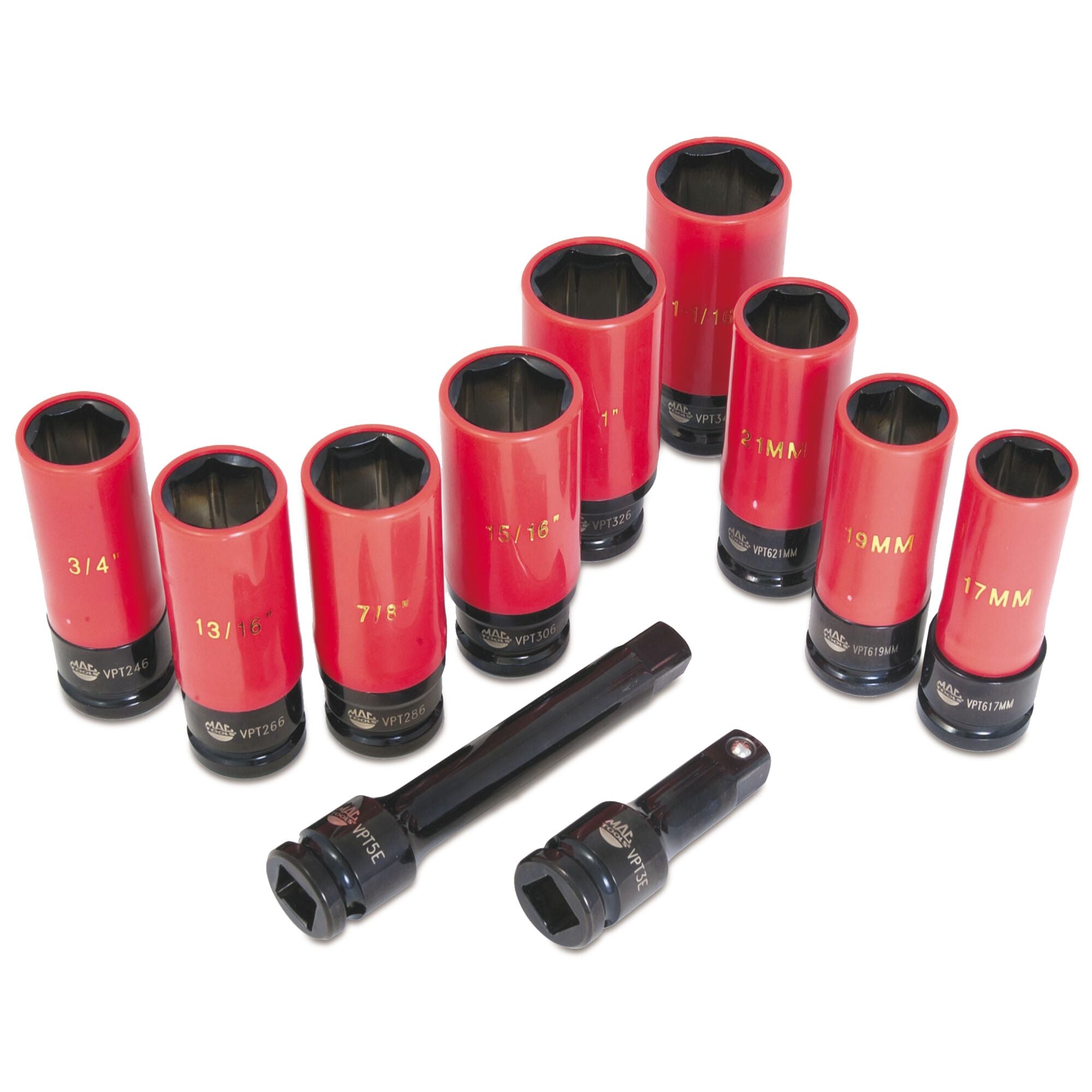

Best Non-Marring Sockets for Wheel Lug Nuts?
impactims
Nov 24, 2011
1,168
Same exact sizes, same exact extensions, same exact look to them, same red sleeve, same shinny looking black coating...
The only difference is the name lasered on to them.
1Bad55Chevy
Feb 20, 2025
623
One of the well known members here blew up the Koken extended version and got the run around about warranty on it too.
As I stated previously, consider all these consumables, especially if used heavily. Some of mine have a 400ftlb max torque warning etched on them.
I don't normally recommend HF but the lifetime warranty might save some hassle and the Pittsburgh Pro set comes recommended.
https://www.harborfreight.com/12-in...lug-nut-impact-socket-set-11-piece-69829.html
A tire shop i use broke so many of those the store stopped honoring the warranty. He is dirt cheap on everything he does there and you can tell by the sound of the impacts he has the compressors turned WAY up so that probably had a lot to do with it.
It is worth mentioning that he said the SO and Matco reps also refuse to warranty his tools...

How about these Snap-on sockets designed for lug nuts? There's no plastic sleeve but just take your time and don't hit the wheels...
Snap on is pretty good about describing the application. In this case it says:
  • Deeper hex geometry allows socket to fit further onto lug nuts, making them less likely to damage or break decorative caps
  • Saves technician time and helps prevent potential customer complaints from marred or damaged caps
I think the key is the term "decorative caps". I'm assuming those are plastic wheel covers, not alloy rims.

this is on sale in the current Mac flyer, $159. Free shipping if you call in to order, just need to pay your local sales tax
No, their product description has nothing to do with plastic wheel covers vs. alloy rims.
When they mention "decorative caps" they are talking about OEM lug nuts that are often two-piece (chrome cap over steel).
True. But he was also a pro working at a shop and probably dealing with **** that was just impacted on at 150 lbf-ft by a prior "pro".
Definitely don't expect a warranty on Kokens, or any of these. I've had the 21mm koken for years and it hasn't broken. Now, maybe that's because I hit them with an impact to ~50 lbf-ft and then use a torque wrench. Some shops run them on to 120+ lbf-ft then check with a 90 lbf-ft torque wrench. Click? It's good. And then the next guy breaks a thin socket on them and expects a warranty?
If Snap On doesn't sell these, it's for a reason.
