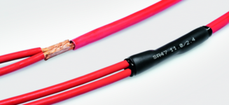

This really looks like a clever solution for automotive and outdoor wiring especially. https://spliseal.com/

Looks interesting and a more reliable fix for weathered splices and connectors BUT that price point puts it way out of anything I'll ever use.
I just about cry over the price of 3M Scotchlok heat shrink **** connectors every time I have to replenish them, but at least I can afford them, and I've not ever had a failure using them for more than 20 years now. The scotchlok's heat shrink and adhesive seems to hold up very well, even undercarriage uses once they are wrapped up with Scotch Super 88, and I like to add a wrap on top of that of Tesa tape if it might rub on anything.
EDIT: I've also managed countless time to use a Scotchlok **** connector in some of the tightest of places, because harnesses don't tend to rub through and meeces don't tend to chew wires to pieces in any of the easy to get to ones, I'm not sure I'd be able to manage to do the same in the same places with that bit of kit.

TO ME, the price outweighs the benefit - especially where adhesive lined heat shrink tubing seals just fine (just as good, if not better). It is essentially doing the same thing as that product (hot melt adhesive forms conformal coating around the wiring) with the added benefit of being self contained, the adhesive melts and conforms from the same heat being applied to shrink the tubing, not so complicated, and the end product is more compact and flexible.
There's cheaper, decent quality, precut versions (and rolls) through Amazon as well.

That's actually pretty neato. And they have molds to address one of the more common needs you can't always manage reliably with heat shrink, which is to make a waterproof connection for three or more wires (two wires on one side, one wire on the other). Sometimes you can get there with glue-lined heat shrink, but it can be dicey to make sure you get a good seal.
The expense of the tools and materials are somewhere beyond the far end of ridiculous, and sometimes it might be hard to ensure the connector is more or less in the center of the glob.
They call the gluey stuff "potting compound" and honestly a translucent compound would be better in some regards, although it wouldn't look as cool as the shiny black stuff.
As far as using RTV, most formulations are corrosive to copper. You have to get RTV that's specifically made to be compatible with wiring and electronics.

$215 for the kit that would do a LOT of home shop connections seems like a pretty decent deal to me.
The whole setup looks pretty slick. Probably not a ton better than adhesive lined heat shrink but a whole lot better looking. I can see one of these in my future.

The molds seem pretty pricey as well ($80 each) - but they do look nice.
Granted, I'm just a DIY guy, but any time I've done 3 or 4 wire connections with heat shrink tubing, I've just run the necessary wires in parallel to fit within the tube:

I have found that liquid electrical tape in a can works very well, a brush is attached to the cap on the can.
These solutions absolutely work, but the result is an almost always unprofessional looking connection. For basic repairs this is largely a non issue, but for many something like this is just the ticket.

Heat shrink connectors are the only way to go. This product is snake oil in the sense that it is inferior to the existing solutions.

The Spliseal setup, however, produces a much cleaner, more OEM looking result. Ring terminals are where I think this product would really shine. The end result looks very similar to 60s and 70s Ford terminations.
Is the juice worth the squeeze? Probably not….but as a hobbiest, it rarely is.

Why's that better than regular heat shrink? You can get the adhesive lined heat shrink if you're worried about water proofing.

Learn how to use a soldering iron and shrink tubing. These overly complex wiring gimmicks are a complete waste of time. I remain amazed by the motorheads who run screaming like little girls if there is wiring involved.
