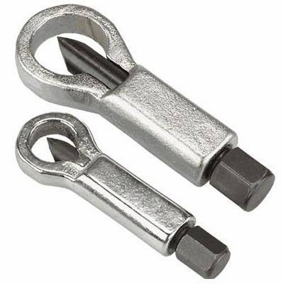

I frequently have to remove rounded off 10mm nut on a battery terminal with space limitation.
If I'm lucky, the closed end will fit, otherwise, it's the more difficult open end.
So far, I've tried with spline, but not very successful, as it keeps slipping.
And each time, this Metrinch save my bacon.
If anyone has other recommendations, I'm all ears.
Thanks.

I have two sizes of the springy nutmuncher wrench here. Like Duck says they grip anything.
The tiny one works great when the hardware is replaced after removal.
That said they get as little use as possible by choice. Destruction is always the last option.

3/8" is 9.5 mm. I have a 2nd rate six point socket welded to a bit of flat bar to cover those corroded nuts. I also carry a 9 mm wrench so none are ever really difficult.
It doesn't have to be fancy or expensive.

I have channellock nutbuster, yes it does work well.
I have Irwin bolt extractor, but I haven't tried using it yet, as the thickness of the tool would be a hindrance trying to fit over the nut where the top of the battery case would blocked it.
Metrinch, spline (if it works) or similar box end type of wrench, with thin walls, would be more ideal, bcuz of space constrain.
