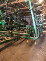

After I finished with fertilizer we took the 8400 and the drill back down to the bottom shed.
We wanted to get the planter out to do some work to it. That required moving the field cultivator with the 8760.
We have to be careful with the field cultivator. It’s a little too big for the shed. You have to make sure it’s at the right height so it doesn’t catch the bottom of a truss or the top of the door when you’re moving in it and out.

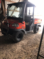

By the afternoon I was back in the shop. I was able to finally get the parts for the Kubota. I got the boots on.
I didn’t have enough time to finish putting it back together before my MU Extension meeting.

This afternoon I finished the Kubota.
It looks like everything I working correctly.
