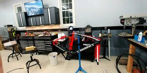

To keep this bike related, my last bike build in 2019 and still my daily when I still ride. It was a little over 16# like it was in pic #2 with no light.
