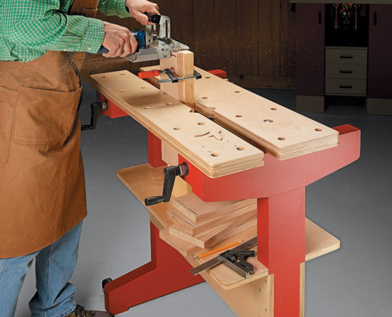

I was just told that in 2009, ShopNotes magazine published plans for a "Project Workcenter" that is a partial clone of the Workmate. The main functional difference is that it's quite large and doesn't fold up, so it's not really portable. The size of the top with the jaws closed is 14" by 38" which gives 80% more surface area than the Workmate 79-001. It's also 37" tall, about 5" taller than the 79-001. Woodsmith Magazine still sells the plans, here:
wolfcj
Apr 24, 2017
601
Yes, it certainly would cost more, especially if you can pick up a vintage Workmate for $15!
However, if the size and weight of this "workcenter" really appeals to someone for the work that they do, a Workmate would not really do the same job for them.

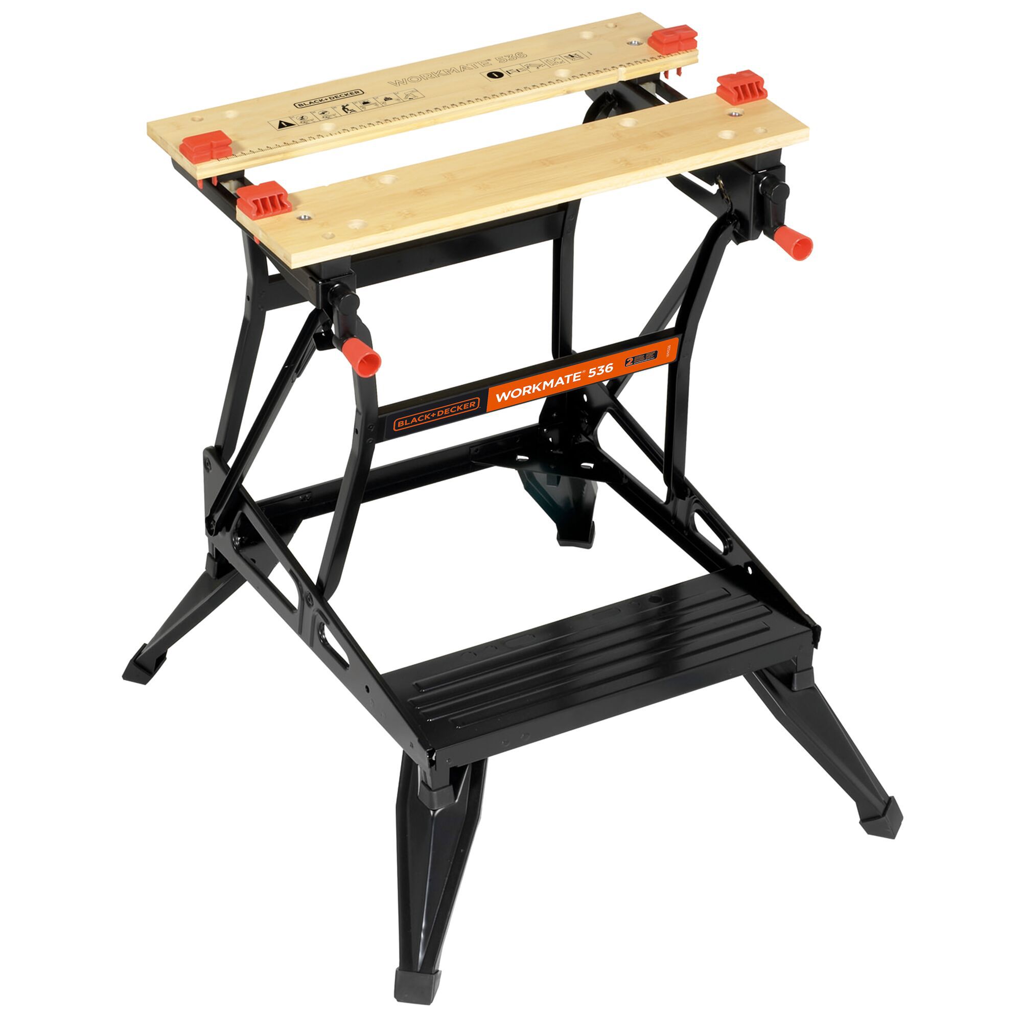

The modern WM I gave my son has laminated Bamboo jaws. I'm a fan of bamboo, BUT its out of reach crazy expensive as just material in this country. so I'm watching for things MADE of bamboo for cheap to get some stock...

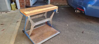

Im from the UK and have a few workmates, but just got hold of this one-
I believe it to be an early mk1, made and sold before B&D were involved, and it's in fantastic condition.
Found this thread as I've been looking across the world for info on these mk1's and although I don't believe these were ever sold in the US, your 57 page thread on them is impressive so I thought I'd share.

The original Workmate is sawhorse height—23". Before Hickman developed the dual-height model, he offered the Team-Mate as an optional extension bench that provided a higher work surface. It is even more rare than the original Workmate itself.

Hi wolfcj.
Think I've seen your site before.
Wondering if you could help dating my workmate.
Any tell-tales that I could look for?
It doesn't have the triangle (design?) sticker, or the Black & Decker sticker on the face of it, and doesn't seem to have ever had these (no sticky evidence etc).
Is there anything you're aware of to support an early dating?
Greatful for any help.

I haven't researched the original Workmate in depth as I have for later ones. This is obviously difficult for me because 1) there are limited numbers of them left today and 2) I am in the U.S. where they were never sold.
However, my impression is that the original Workmate changed very, very little from its original sales direct to consumers by Mate Tools starting in about 1968, to the year or so (1971-72) when Mate Tools made them for Black & Decker.
The one variation I have noticed is the holes in the jaws. Some of them have either one or two circular metal plates set into the front jaw that appear to be intended to accommodate a standard woodworker's hold-down. You can see this in the last photo on my blog page. That one also has four of what appear to be bench-dog holes in each jaw. Since that photo includes the Team-Mate, which I don't believe was ever sold by Black & Decker, I would think it shows what we might call a middle-period Workmate Mk. I that would have been sold by Mate Tools. It's the only one I recall seeing with the eight bench-dog holes, so it's also possible that it was a prototype idea that never made it to production.
However, I have seen marked WM125's that have the metal hold-down holes as well as ones that do not have them, so it's hard to figure out a timeline for them.
Your Workmate shows the more common variation with two small holes in the front jaw, whose purpose is not clear to me. I have seen that on both Mk I's and on WM125's. Do you know how those two holes would be used?
The triangle sticker is normally at the very front of the right-hand lower side rail, which isn't shown in the photos you posted.
Yours could very well be an early one, but at this point it would be hard to confirm. It sure looks like a great one however!

Thanks for reply and good info.
No idea what the holes are intended for, and I've been trying to find an early manual or some photos that may indicate, but not found anything yet.
However it is well advertised and in many photos that it was also intended to be a seat (the chair he cut up replacement??) where you'd sit and work on you piece either held in the jaws you are sitting on, or infront of whatever you're doing.
I get the feeling the metal collers were a tweak to the origonal design, but again unsure of their use, and I don't have anything factual to support that other than all the early photos I've seen just have the holes like mine.
Mine came from an elderly gentlemen who sadly passed away.
He had built a house to his own design and the whole of his ground floor was given over to his passion - woodworking.
Apparently he was a woodworking teacher both at school level and I think at trade level and so cared greatly for all his tools. And whilst the family were clearing his estate (selling some, charity donating lots of other things) he had about 4 'workmates' of various manufacturers.
Indeed I also bought (new in box) a draper expert magnum 1000 workbench. I'm building a bespoke shed and thought it would be a useful workhorse for that project.
But....it's ugly and feels 'gimmicky' compared to a real workmate, so very likely to be sold on after this project. 🤣
Strangely (as I can be strange..) I haven't cleaned the (little) amounts of sawdust off the mk1. I guess in some sort of homage to the gentlemen at the love he likely had for it.
