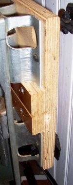

These are the older jaws the Aluminum frame model has; Note it's hi-grade ply and they added a secondary piece to make the jaw face thicker. I like this feature, adn recoment better materials for the jaw...
If you can source it, I bet bamboo would make killer WM jaws...

This is what I used. It's a 13-ply no-void plywood. Get a 24" x 24" piece and have some leftover. A 20mm Forster bit is needed if you are going to use the original dogs. Or, buy 3/4" ones from Rockler and drill 3/4 holes.
http://www.appleply.com/

That would be a good choice! did you double the faces?
Not sure what I'm going to do when I weed down to fewer WM's.. I have a bunch of tools setup for clamping in the single thickness jaws. Maybe I keep one of the three 200's for a dedicated power tool stand...
If I suddenly had unlimited space I'd make a bigger bench and embed the hobby or table top model into the bench top to do the job...
