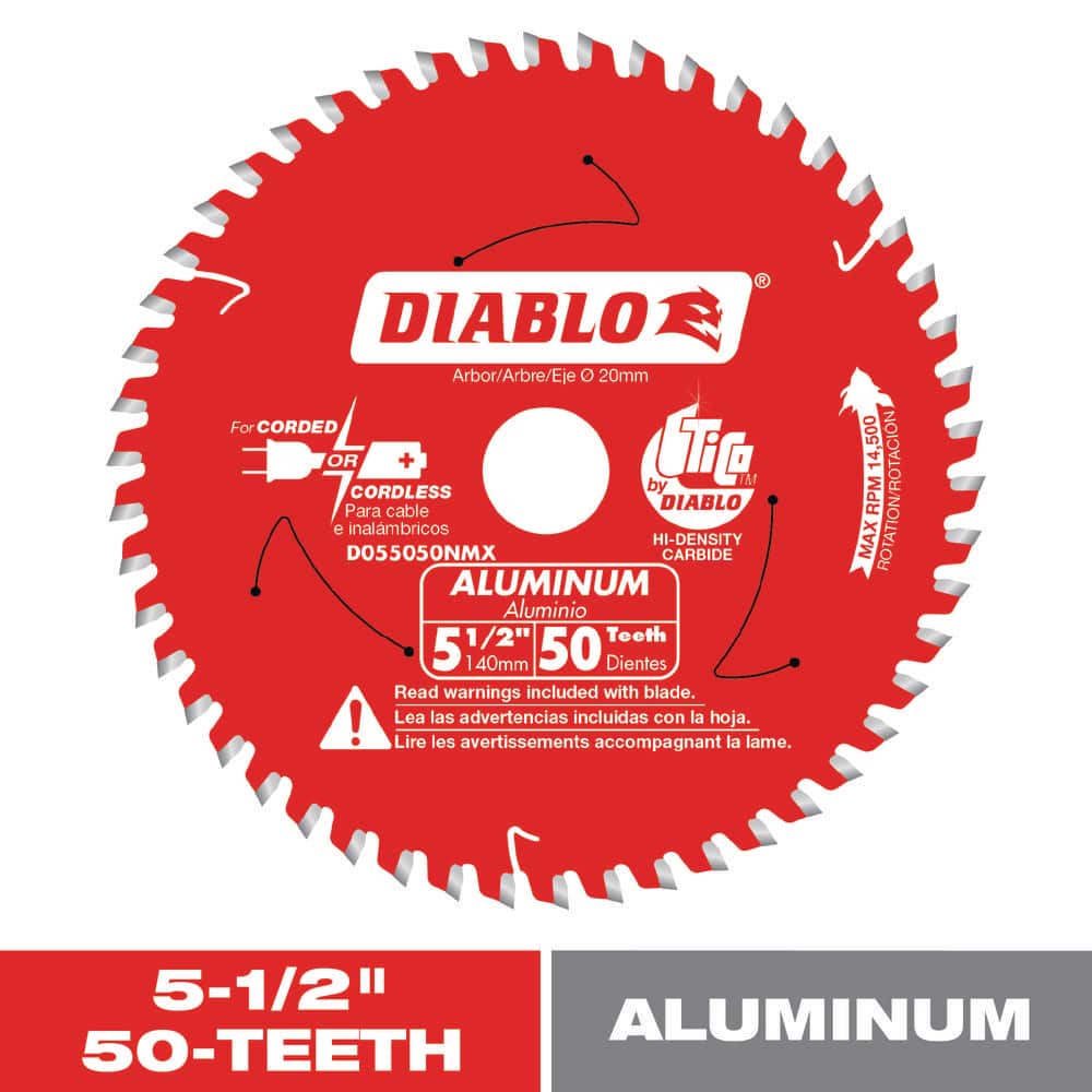

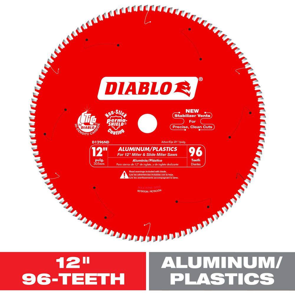

We cut a bunch of extruded alum with a Diablo alum blade; works really well. Don't cut super fast. I bought 4 blades thinking we'd burn through them, only used one for about 25 threasholds.

Might be worth buying a blade:
But again, I use my finish wood blade all the time for a few cuts. Keep the open side of the extrusion down to avoid the teeth grabbing, and feed the saw slow and consistently.
Wear ear/eye protection.
