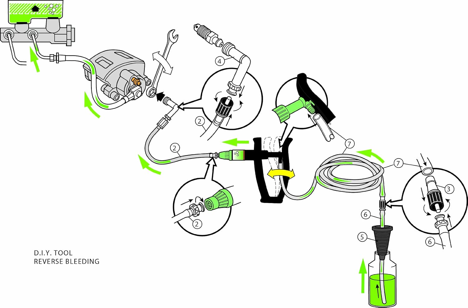

2. Reverse-injection bleeding *****. It ***** twice as hard when you buy some expensive tool to do it. All you need is to PUSH THE CALIPER PISTON(s) BACK INTO THE CALIPER. Of course, drum brakes are going to require some sort of special tool. The problem with reverse-injection bleeding is that it can only be done on a clean system or you're pushing contaminated fluid back through the ABS valving and the master cylinder. The fluid at the wheel cylinder (including caliper) is probably the most-contaminated fluid in the vehicle. So first you're bleeding in the regular direction, to get clean fluid into the caliper, so that then you can push it backwards? Friggin' crazy. The only time this makes sense is when the system is totally empty and clean. And THEN, you still have to bleed in the normal direction to finish the process, because the bleeder screw is always higher than the hose leading back to the master cylinder, and so you'll leave a bubble in the wheel cylinder unless you final-bleed out the bleeder screw. Does "Phoenix" tell you this?
