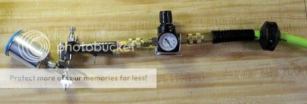

Took a break from storytelling and did a few projects in the yard, including straightening up the sprinkler system (and adding a 10-foot length of PVC and a spray head to one section).
[FONT=&quot]For fun I decided it was time to fix a small problem with my paint sprayer setup. Because I set the regulator at the compressor to maximum pressure, I need to be able to regulate the pressure at or near the spray gun. I also need to be able to disconnect the gun for cleaning between paint sessions so I need quick disconnects. This is my worst-case setup, almost two feet of inflexible brass [FONT=&quot]behind the [FONT=&quot]gun nozzle, with [/FONT][/FONT]two plugs, two couplers and a regulator (the hose reel donut is a bonus to make it e[FONT=&quot]xtra[/FONT] heavy[FONT=&quot] and clumsy[/FONT]):
[/FONT] That’s a lot of weight and a very cumbersome package. The gun is a small Iwata LPH80 that I want to use to spray epoxy primer on the frame of my Corvette. I use a BreatheCool supplied fresh-air system that has a long hose that attaches to a belt and a quick coupler on a short hose to the full face mask. I want the spray gun hose to hook up in a similar way.
The small diaphragm style regulator has no handy mounting points so I decided to make a holder from some scrap 1/8” aluminum plate. I abandoned a telephone jack cover plate project and the piece looked just right for my regulator belt clip.
This is a perfect job for the vise-brake I bought a few months ago.
A couple of bends on the big piece of aluminum…
A couple of holes using a step-drill bit…
Bent the leftover piece of aluminum, drilled one hole in the bent side and two holes in the long side, used a couple of #6 nuts for spacers and pop riveted the piece to the back. I had originally planned to use a tape measure belt clip but it just didn’t look sturdy enough. I had also planned to rivet both ends of the clip to form a belt loop but decided I needed to be able to remove the regulator without undoing a belt.
Made the final bend with the vise to capture the two threaded ends. A quick connect on one side and a plug on the other and it was done.
I have a four-foot snubber (whip?) to connect the gun to the regulator on my belt. It keeps the hose out of my way and keeps a lot of weight off my hand.
[FONT=&quot]It took me about an hour to make but I think it’s going to work well, especially when I’m lying on my back and spraying the frame overhead (frame is sitting on jackstands with the car body raised six inches with allthread). The tiny gun should be able to reach inside the tighter spaces.[/FONT]

That's a great idea. Good work there Bob. I'm gonna steal that idea.
Thanks Gerard, I have GJ to thank. Every time I tried to bend a piece of aluminum using just the vise jaws, the aluminum cracked. The vise brake makes a nice tight bend but I think I need to grease the aluminum so it doesn't get marred.
Cleaver idea Bob and well done.
I have just brought a vise break and boy are the handy.
Regards
Steve, the vise break is great. My only problem is I spend too much time looking for ways to use it. I haven't always had the money to buy tools but when I buy one, it doesn't just become drawer decor. I have to use it right away. Sometimes that means spray painting a stump just to try out a new gun.
Toolfool
Aug 22, 2011
4,983
Tallahassee, FL
Great idea, Bob. I've been wrestling with a pressure regulator and fittings (and that same donut) attached to my RO sander. Problem solved. Now I just have to buy a vise brake.
BBChevro
Jan 24, 2014
2,235
Brisbane, Qld., Australia
Top idea Bob, I've often thought that a pressure regulator near the gun would be good, but the extra bulk has put me off the idea - I always just take a guess at the pressure drop (and set a higher pressure at the regulator), but it takes a while to sort the gun out.
I try to keep the guns as light as possible - I use a barb fitting in the gun with several feet of hose so the quick-connect fittings are further away.
I also have a dedicated hose that I use for air tools to avoid any oil contamination in the fittings.
B
Bob Heine
Oct 24, 2009
10,708
Boca Raton, Florida
Thank you John, I tried solving the problem with smaller regulators but the small regulators are all choke-style. As the pressure in the tank drops, the flow in the choke regulator drops as well. The diaphragm regulator is a better choice but I haven't found a small one yet.
I would apologize for the vise brake epidemic but once you catch one, you are going to be hooked for life (unless you already have a giant Baileigh finger brake).
Thanks Mark, glad you like the idea. I'm with you on the gun weight. It is especially important when you have a litre of paint in the cup -- every little bit counts. The hose I have for the gun is a very light 1/2-inch diameter 4-foot Flexzilla. These new(ish) HVLP guns need as much volume as possible so the hoses on my reels are 1/2-inch.
I have 1/4- or 3/8-inch 5-foot Harbor Freight whips on all my air tools so I don't have extra weight on them as well. I also have a dedicated 4-foot triple-outlet hose that I use with air tools (keeps oil out of the main hoses as well). It is rare for me to be using just one air tool at a time. At a minimum I have a blow gun and RO sander hooked up.

Great idea Bob. It also keeps the hose behind you better than just throwing it over your shoulder. I also like your air gun holder. Please post some more on your moisture removal system.
p.s. Grizzly vice brake is enroute as we speak.

Spray gun cheater valves are usually right there at the handle.
You don't need a gauge as you will be dialing in the pressure at that point by the spray pattern. Narrow the pattern and reduce the pressure and/or close down the gun needle on the fly.
Zeke, I am on the "know nothing try anything" side of painting. Until recently all my spray guns were relatively cheap and a couple of them are siphon/pressure feed. If you are the owner of a Binks 2001 gun you are obviously on the expert side. Those Binks guns are selling for pretty good money on eBay.
I have been trying out some better guns and they are great but seem very sensitive to pressure changes (my compressor swings between 90 and 120 psi). The cheater valves I have change the spray pattern as the pressure changes so I was trying to get a more consistent result with the diaphragm regulator. I do go by the spray pattern rather than being a slave to the gauge. Just trying to eliminate everything but my skill as variables.
My first spray gun was a Craftsman siphon/pressure feed and I still have it. Bought it back in the mid-60s so I could paint the cedar shake shingles on our house (brushing was nearly impossible. I still remember slinging the quart of paint around until my arm was on fire.
As a confirmed tool hoarder, I don't throw away/sell many tools. I found latex paint was best sprayed with a pressure setup rather than siphon feed so I converted the Craftsman to pressure pot feed, like the one you show. I also have a collection of cheater valves in addition to the diaphragm regulator.
I had an excuse to by another pressure pot gun when I had to paint the bronze panels at the base of our screen enclosure.
The Craftsman gun didn't handle thin paint very well so I bought a Harbor Freight pressure feed gun and 2-quart pot.
A few years ago I discovered acrylic lacquer paint was no longer the rage. If I wanted to paint my Corvette myself I would need a better spray gun and to meet pollution restrictions the gun would need to be HVLP gravity feed. Rather than asking for advice (pre-internet-forum days) I ordered a two FinishLine gun package from Eastwood.
