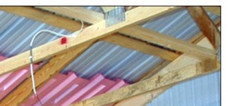

Yes another bookshelf girt thread, sorry for that. I've considered many different ways to finish the enclosed side of my 36x60 pole barn.
I think I have a couple of challenges, but maybe those challenges are from lack of planning or inexperience. The posts are laminated 2x6's, so in the corners you would have the eave posts 90 degrees out from the gable side posts. No big deal, but there would be an offset of 1" (4.5" vs 5.5"). I think my choices are to run 2x6's horizontal / bookshelf girts flush with the posts, or 2x8's so they project out 1.5" beyond the post (but 2x8's are 7.25"...arrgh). Going the 2x8 route also puts the future wall on the eave side flush with the 2x4 under the header, while the header itself is actually projecting yet another 1.5" into the building (it's 2 piece LVL / sandwiched).
I've seen some guys orient the BS / horizontal girt in an "L" configuration as opposed to a "T". Thoughts on that?
Sorry if this is not making sense.
The other challenge I have is that the ceiling liner dies flush with the outside girts. I really don't want to take it down and trim it back by "x amount" to accommodate for the wall covering, but it looks like I need to. Or figure out the offset amount and get to cutting, which I really don't like cutting corrugated metal.

Decided on 2x6 in a T configuration against the girts.

Do you think I can remove the nailing blocks that are underneath / supporting the header? Are those placed during the construction process, but in the end not really supporting the header that’s nailed to the post, and in this case another header nailed to the 1st header?

I've never seen ceiling run that way. I would just use closure strips to seal up the edge and **** your wall covering up to that. No sense in getting too out of control with it.

Not much sense in building such a tightly framed wall within a wall, either. But he's already doing it. Kinda defeats the 'savings' of post-framed construction to build another stud wall within it.
Question for the OP, are you doing this to all the walls of the structure, or just some areas as support framing for an interior wall skin that later shelves / storage will be attached to?

Builder said I can take them down? But to run (2) 5-6” structural screws through the headers into the post.
Do you have a copy of the erection drawings for the building?
If they are shown on those drawings I wouldn't change them, unless the manufacturer is willing to revise the drawings stating this, showing exact locations of the screws I wouldn't do it.
They also need to specify exactly what screws to use: manufacturer, type and size.
If they aren't shown on the drawings, ensure that the nailing schedule shown was followed.

I do not have a copy. By the looks of the blocking and the amount of nails used, I’m not sure if a schedule was followed. There are TON of nails in each block. I’ll have to take a picture.

All that's needed? The need follows the function.
The T-Girt configuration that Dyno Dan is implementing using 2x6's provides much more rigidity than simply nailing 2x4's to columns on 24" centers.
And when building the T-Girt, if the horizontal girt is nailed or screwed to the vertical girt it creates a very strong wall section.
If you don't plan to hang anything like wall cabinets on the walls and are ok with bowed walls, your 2x4 method is fine, but it certainly isn't very strong nor does it allow good utilization of space.
