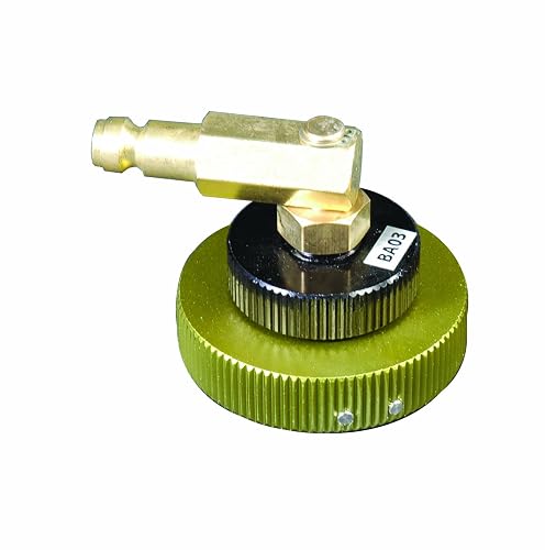

What I've used most recently and is hands-down my favorite for bleeding automotive brakes is the
Power Probe Brake Bleeding Adapter. These are custom machined aluminum caps that go on your master cylinder and connect to your shop compressor at low pressure. It's kind of like having endless travel on your brake pedal and an assistant that always keeps the perfect pressure on the pedal. As it only uses the fluid in the master cylinder reservoir, you do have to top it off before beginning, and keep an eye on the level, and if you are doing a complete flush rather than a bleed, you'll need to pop the cap off and refill a few times. This extra hassle IMHO is more than offset by not having to clean up the leftover brake fluid from the Motive and store a garden sprayer sized device... Just throw the adapter in a small ziplock bag when you are done, no cleaning, super small to store, and it's ready for the next bleed.
They make a ton of different varieties for different cars, but the euro adapter (BA05) and the Ford adapter (BA03) fits every car I own and work on...
