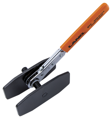

What is the best style of caliper spreading tool for dual piston calipers?
I see three general types :
Squeeze handles, looks like it would be difficult to use if the caliper resisted.
Ratchet handle, wide pads that cover both pistons.
L-shaped, looks like the strongest, but needs the old pads to press against.

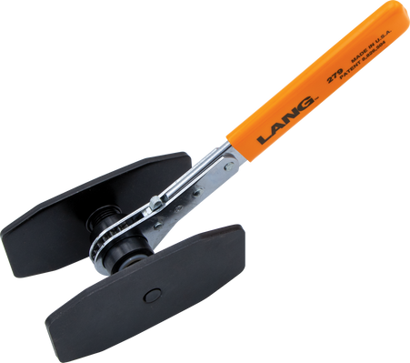

It really depends on the caliper. Does it have the semi-circle cut out in the center of the outside ears? If so, use the old pad and a C-clamp. If not, the ratcheting ones work decently, with the side benefit that they'll be useful for any 4-piston calipers you might work on in the future.

I use c-clamps, Lang 279 Brake Caliper Press, old pads, spacers of some kind, and whatever else for each specific job makes it easier... Most of my work is larger diesel pickup trucks like F250-F450 or Dodge equivalents so sometimes i get creative because calipers can be big LOL.
My son has a Subaru CrossTrek but its only a year old and hasn't needed brakes so i'm no help there yet specifically...
In general, I do like the Lang.

In have the Maddox service set. It's been good to me. For dual pistons (my SUV has dual piston calipers), I use the old pad, and center the tool as best I can, and swap back and forth to get both leveled out. Maybe not as convenient as a true dual piston tool. Working on my own stuff, speed isn't as much a concern.
A lot of guys seem to like those ratcheting presses from Lang. If I had to do it for money, I would be considering those myself.

So I do I need both sizes? None of the ads show actual dimensions. I’m not ear a caliper I can check right now.
I’m sure I would need the larger one for my Ford pickups, but would it fit the smaller calipers, like the Subaru?

The larger version is for larger brake calipers, most commonly found on front brakes.
The smaller version is for smaller calipers, most commonly found on rear brakes.
That's not to say the larger version won't work on rear brakes, I've used mine for both front and rear plenty of times.
Also, it's designed to be used for quad piston calipers, but it works just fine for single and dual piston as well.
Replying to my last post. The big tool will not fit a Subaru front caliper, ordered the smaller one last night. Question is moot for this job anyway, as one piston is seized at maximum extension. I knew we were in trouble when the bridge bolt broke off on the first try. I’m going with two new calipers. Haven’t disassembled the rear brakes yet, but what I can see through the spokes of the wheel doesn’t look good.

These can pretty much do anything, except twist in style calipers... But buy them on Amazon.
I just bought the 279, and I REALLY like it. I used to use the Lisle pistol style, but they're a bit hard on the wrists with bigger pistons. They're too big for the smaller calipers, so I'm thinking of either the 277, or another smaller option snap on has - btcp400, which seems more versatile but is 2x the street price of the 277. I don't like the rod that sticks out of the 277.
