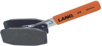

If you have a pad between the rotor and the screw driver then what is between the piston and the screw driver ? Gotta be careful, you might mar the piston.....

I have never used a tool at all. Just use your hands to compress the pad a bit, then rotate the old pad 90 degrees to push the piston back in. Also works great at the track 'cause you need no special tools that are invariably back at home.
On a single or dual piston caliper where the pistons are on the "inside" or closer to the vehicle you would stick your screwdriver in between the outside of the pad and the caliper. You may have to pry on the pad a bit until you get enough gap to get on the other side of the pad but there are no pistons on that side of the caliper. Your basically forcing the outer pad, rotor, and inner pad against the caliper pistons. Same thing with a 4 piston caliper if you do one side at a time. I know some toyotas will let you do that. If they have to be compressed at the same time then you'll have to put the screwdriver between the pad and rotor on each side, cross the screwdrivers and pull apart and push together like your opening and closing a pair of scissors. I have never damaged a rotor this way but i also machine them almost every time. Also, the bleeder should be cracked anyway making the amount of pressure required to compress the pistons very low. Either way, there is nothing wrong with using the right tools.

I have these two, always work great...I have a few 1/4" thick plates that are cut in the shape of brake pads too if I need to combine that with one of these tools...
Piston Compressor Tool
Lisle Dual Piston

How did you manage to turn that LITTLE t-handle to compress the piston?? You must be one big fella ...
I'm 5'10" 160lbs and I've used that thing on several different calipers without opening the bleeder valve. I think if you can't do it there is likely something wrong with the brake system or maybe a 1-way check valve in the ABS unit. If you have ABS you should open the bleeder valve anyways....

When I do disc brakes I use either my:
Snap-On GA395
Matco DBPS260
OR for the stubborn pistons:
20" BIG MAC CHANNELLOCKS
and for rear discs:
Matco DB25

At 160 per axle it is most def not including new bearings. You might want to try OTC 7034. That is a cheap/effective tool and works basically the same way as the one you posted. Not quite as sturdy/beefy but I've done cars and motorcycles with it.

I wish there was a tool that worked like a clamp that squeezed it when it was still on the car. So since I live in ct, it's always the c clamp to get over the rust lip.
Yeah, maybe I'm remembering 1990 or something, when I paid $100 per axle for bearings on the Minima (Datsun 210 Sedan).
Thanks, got the Performance-branded version of the OTC 7034.
