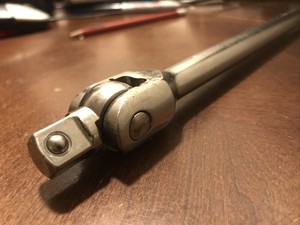

dont think I ever broke a breaker bar but I did bend a 1/2" one way over one time and was worried it might break
It didn't break tho and came right back to straight. It claims to be a P&C 6238
Anybody know what that is?
got it used 50 years ago so dunno it's real age - maybe Ming Dynasty?
ok, Alloy Artifacts says P&C was a subsidiary of Plomb Tool (later Proto). It was acquired by the Plomb Tool Company of Los Angeles in 1941, but they don't say if they continued using the original trademark to stamp the tools.
